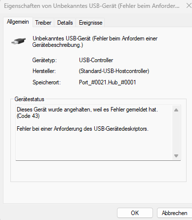

The only error I get is a driver error on my Windows pc.

I was looking at code 43 solutions.
Try above first.
Here's the steps you can try.
-Press Windows key + X
-Go to Device Manager
-Expand the Universal Bus Controller
-Look for USB 3.0 Extensible Host Controller and USB 3.0 Root Hub
-Right click and hit Uninstall
After restart the driver will be automatically installed.....Redirecting
