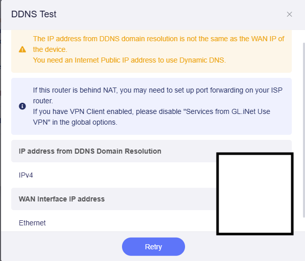

When i went to Dynamic DNS of the home beryl and ran DNS test, i get the following error -

Hi!
If Beryl is not currently connected directly to your ISP modem and obtaining a public IP address, it is normal for this message to appear.
It can be safely ignored as long as the following two points are met:
  1. Your ISP provides you with a public IP address.
  2. Port forwarding to Beryl's Wireguard server port has been configured correctly in your ISP modem/main router.
