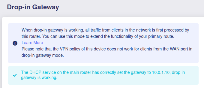

Having a RPi PiHole server isn’t bothering me. The reason I want to ditch Drop-in Gateway is this:
Selection_005
I’d love to be able to use VPN also with my Ethernet Clients not only with Wi-fi.
