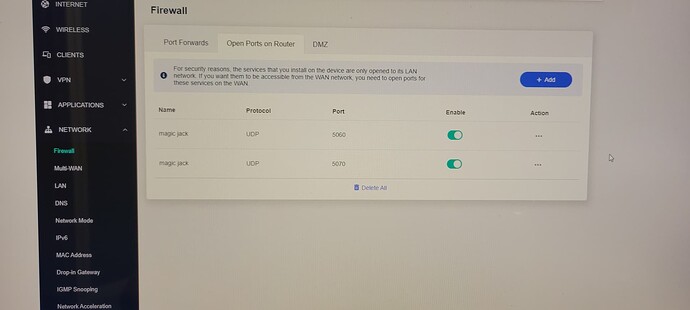

How did you exactly configured the firewall?
Go to "Network - Firewall'. Could you send is a screenshot from this setting? If you feel better, blur out the internal IP.
I didn't configure the firewall at all. There's 3 taps when you click it. Port Forwards, Open Ports on Router and DMZ.. Only thing I did under the firewall was opened up the ports 5060 and 5070 like it says on the Internet for Magic Jack. Don't get me wrong, I know how to research but I don't understand any of the customization "AT" commands with this router

And on the page is exactly the issue.
We have the WAN, the Router, the LAN and the Devices in the LAN.
On the tab 'Open ports on router' you've managed that requests from WAN will be send to the router itself. But there is no service, nothing happens.
  1. Delete the two entry from 'Network - Firewall - Tab: Open ports in router'
You want to forward the ports to your phone. So you need to know the IP if your phone. But the router will give you a list of attached devices.
  1. Go to 'Network - Firewall - Tab: Port forwards'
  2. Add a rule:
  • Name: VoIP5060UDP
  • Protocol: UDP
  • External zone: WAN
  • External Port: 5060
  • Internal Zone: LAN
  • Internal IP: [Select from list]
  • Internal Port: 5060
  • Enable: Acive
Do the same for the port 5070 ...
But this will only guaranteed work if the SpitzAX is connected to the Internet via WAN. If there is a secondary router between Spitz and internet, this one will need the forward rule as well.
