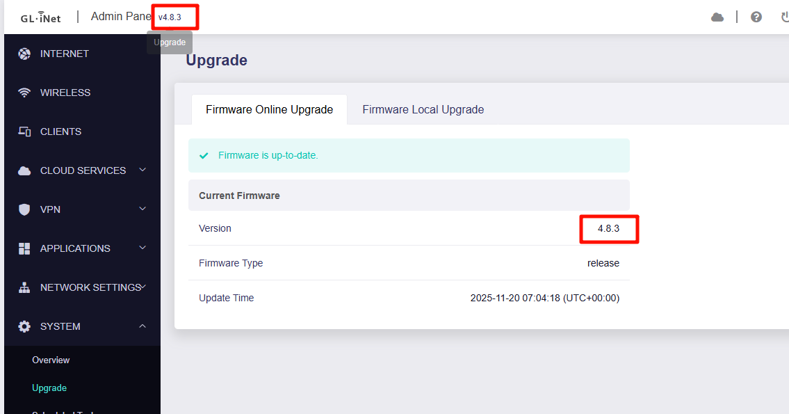

  3. Let us know the GL firmware version currently installed. You can find this in the top-left corner of the Admin Panel or under System → Upgrade.

firmware is the latest, 4.8.3. I have previously tried factory resetting, not change. Ill pm the logs in a few minutes.
