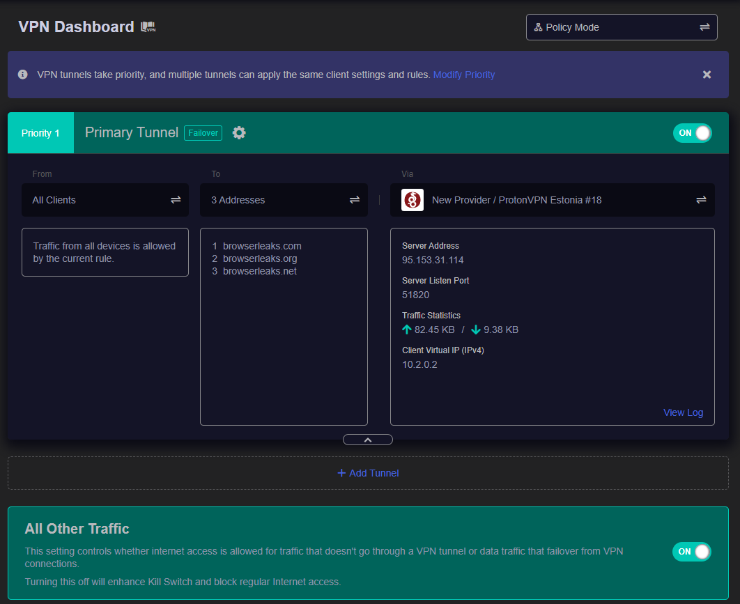

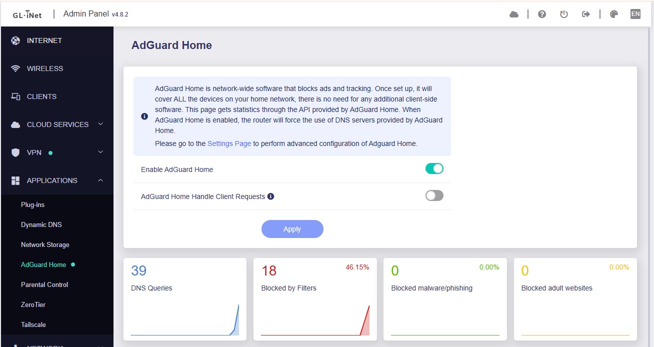

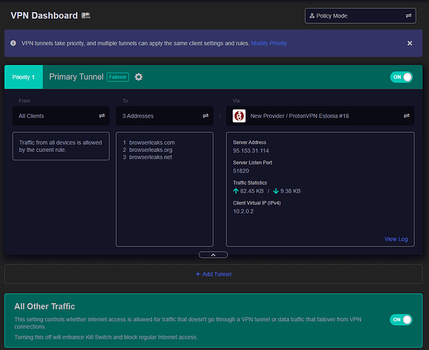

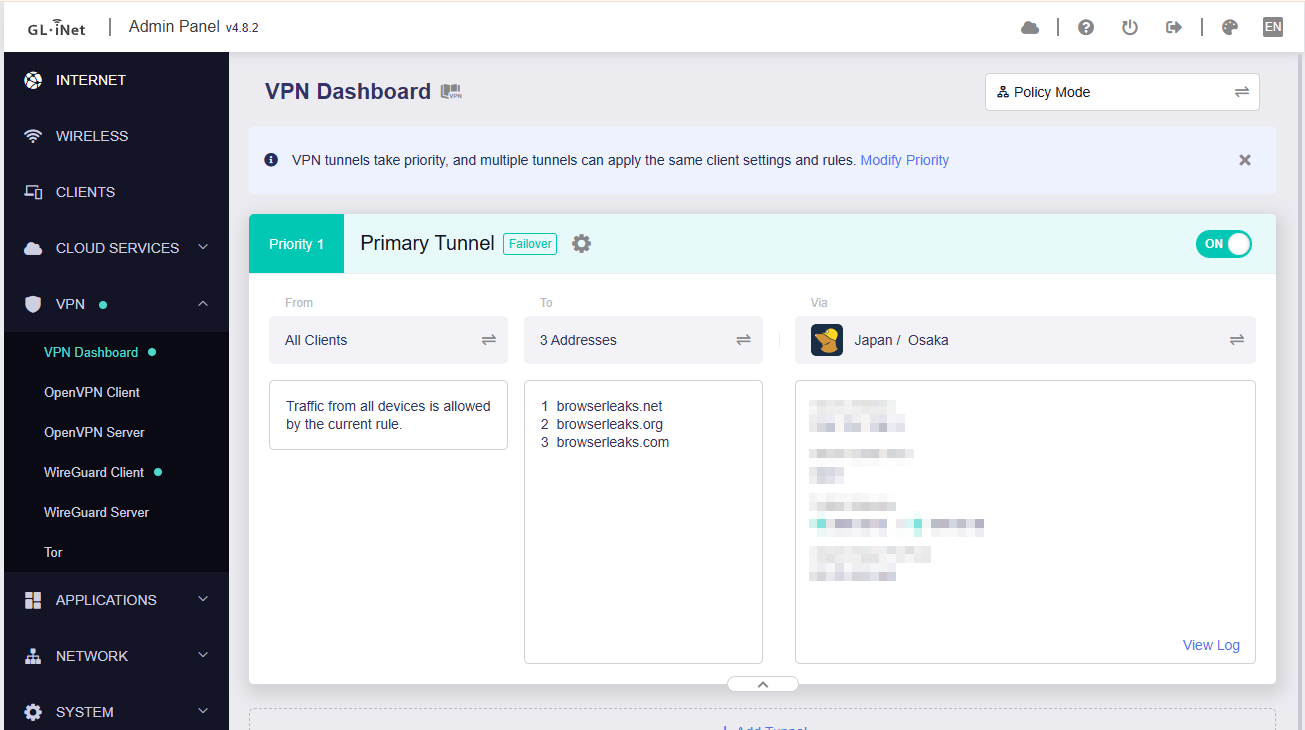

I’m trying to route a bunch of domains over a VPN using Policy mode. I am also using AdGuard Home for DNS. Whenever I try to access these domains I can’t because of a DNS timeout.

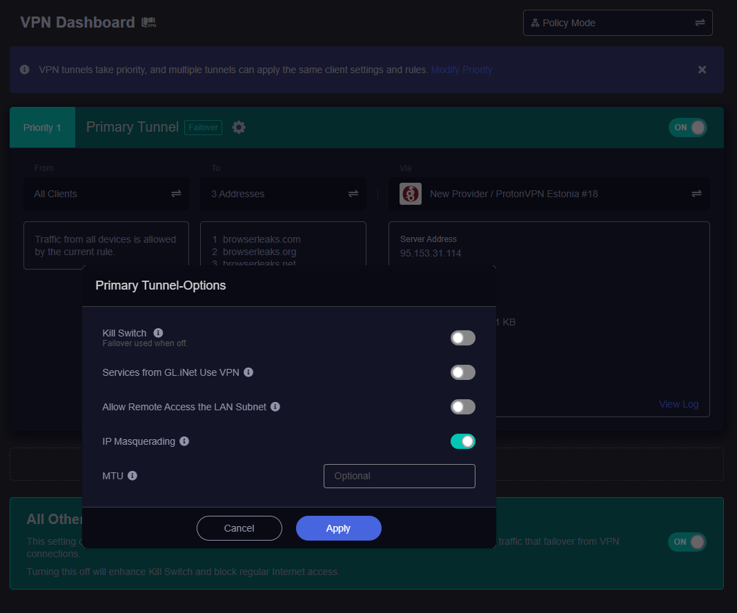

My config is below. The issue occurs regardless of whether procd_set_param group
is set to nonevpn
or explicitvpn
. Can you help please?

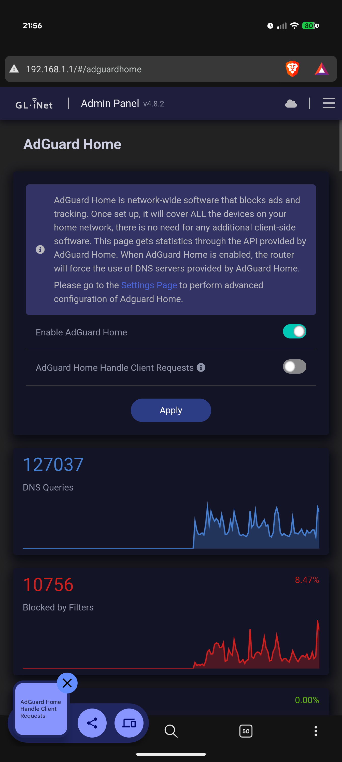

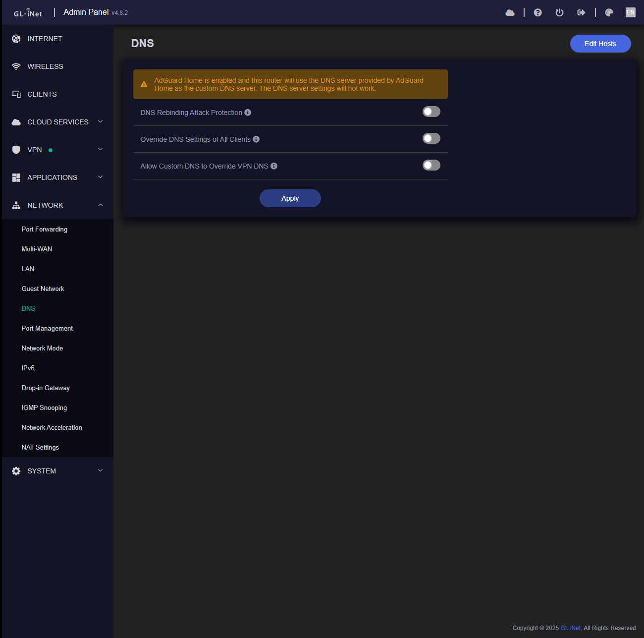

I think it's related to the DNS management on the router. If I use secure DNS like the DNS over https then I can browse to the website. But obviously it doesn't go over the VPN because the router doesn't know about the DNS request
