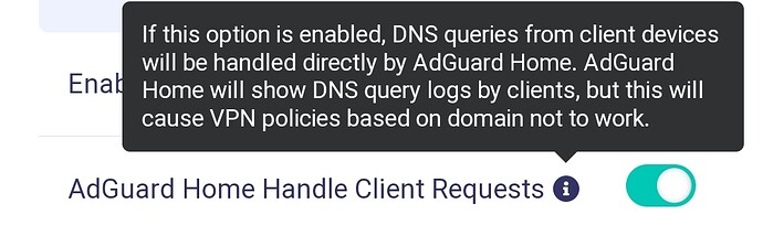

Like I said in my 2nd post. It seems the description is misleading:
That is NOT needed it seems for communication between adguard to dns server (upstream), just for web interface and lan to adguard, which is not used anyway because:
So I guess I can leave it deactivated and just use:
You won’t see logs from Adguard Home. Looks like your made router dns server with dhcp (inside luci) . Just leave 2nd dns server for someone static devices to connect adguard home server.
Not sure what youre talking about. No, I did not, never touched any luci settings. The option “AdGuard Home Handle Client Requests” is disabled by default. seems you (accidentally) activated it on your device in the past. the default is dnsmasq => adguard => upstream.
also what logs? I see logs/statistics with the option disabled.
