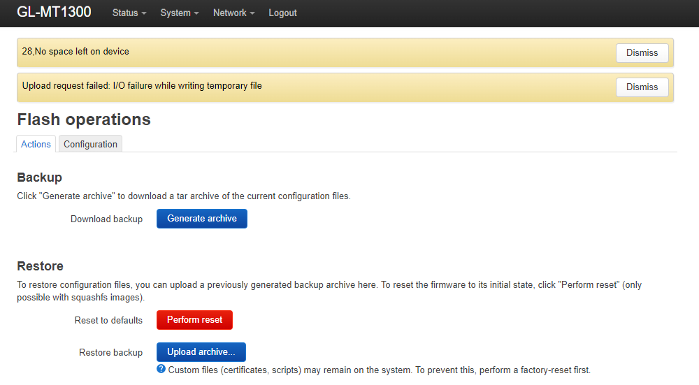

What is the size of the firmware file you uploaded? It should be 58.07 MB.

Can you check the available memory of the router?

Yes, the firmware is about 58MB. If that’s the right size, why would the router complain?

- I tried to upgrade the firmware with the latest one (admin panel): https://fw.gl-inet.com/firmware/mt3000/release/openwrt-mt3000-4.4.5-0811-1691754744.tar (Error: File is too big)
- I tried to upgrade with the latest (uboot): https://fw.gl-inet.com/firmware/mt3000/release/openwrt-mt3000-4.4.5-0811-1691754744.img Error is below:

Ok, sorry about the confusion. I just realized my unit is the GT-MT1300 (Beryl) and not the GT-MT3000 (Beryl AX). I was trying to install the MT3000 firmware on the MT1300 device. Once I chose the right one, it worked. I am glad I could restore my settings before doing this.
