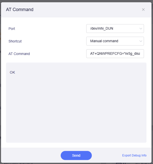

Can't use NSA Spitz AX
i keep trying
AT+QNWPREFCFG="nr5g_disable_mode",1
gives an ERROR
i select band masking and block SA doesnt work
i do band masking NSA Open along with LTE doesnt work
im using Verizon
without the one works just gives
+QNWPREFCFG: "nr5g_disable_mode",0
OK
We have tested the command on our end, and it executed successfully.
This suggests that the issue you are experiencing may be related to the way the command was entered or the specific configuration of your device.
Please double-check the command's spelling and syntax, ensuring there are no extra spaces or typographical errors.
The exact command is as follows:
If the problem persists after you have confirmed the spelling is correct, please share the exact output or error message you are receiving.
Additionally, please note that the availability of a NSA network depends on both the cellular coverage in your local area and the specific ENDC (E-UTRAN New Radio-Dual Connectivity) combination supported by your carrier.
To check for available NSA networks nearby, you can run the following command. Please be patient, as this process may take some time while your device scans for all networks in the area.
AT+COPS=?
@LokiMan if you are copying and pasting the commands make sure the quotation marks are pasting properly. I had an issue where they did not and if I manually replaced the quotation marks after pasting the command it worked.
