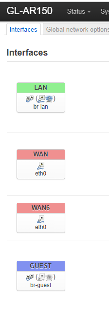

FYI. I changed the MTU Override number in the LAN setting in AR150 LUCI to some number. to 1392. Is it advisable to change default LUCI setting? Did I just messed up with LUCI?
I thought by lowering the number, the connection will be better for other devices too when NOT using the VPN via the GLInet router.
Okay, I will only change the VPN client setting. I already carelessly changed the LAN MTU in LUCI to that lower number 1392 and then changed it back to 1500.
Hope there is not something fundamental I changed there… I only changed the override MTU number.
