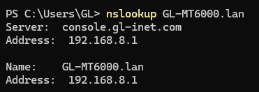

I believe there is already a .lan domain available — hostname.lan, such as GL-MT6000.lan.

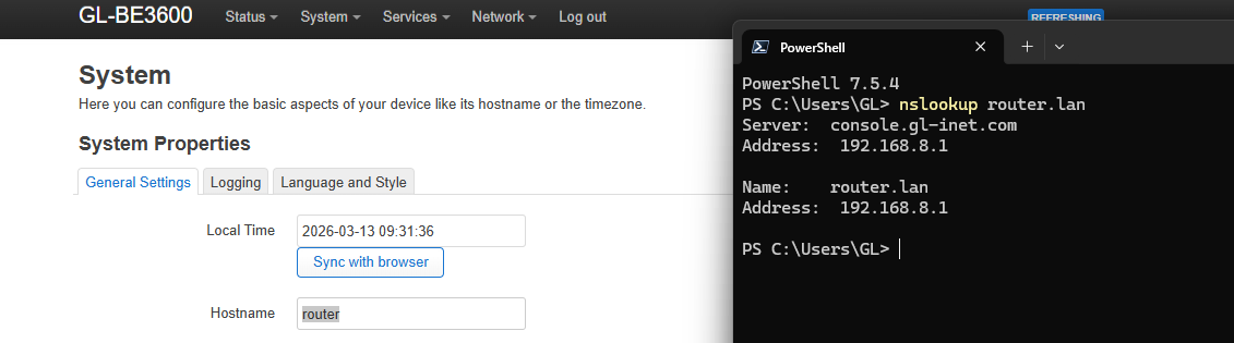

Then maybe change to router.lan? Or something similar? Because that letters and numbers not really easy to remember...
That's just a hostname, so you can change it to your liking in Luci - System - System.
