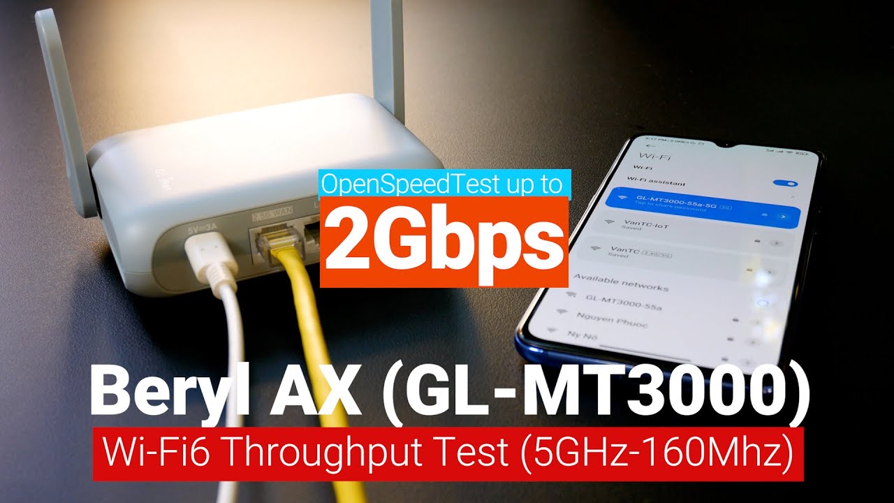

@macuser79 welcome to the forum, I have a video for you from the YouTuber vantechcorner:
I believe your WiFi issues are a configuration issue, would you be able to confirm your WiFi settings?
HI,
thanks for the video..and that I had seen.
The problem is that by setting it in this way the speed was increased but not to reach the actual declared performance.
I still have to figure it out though
