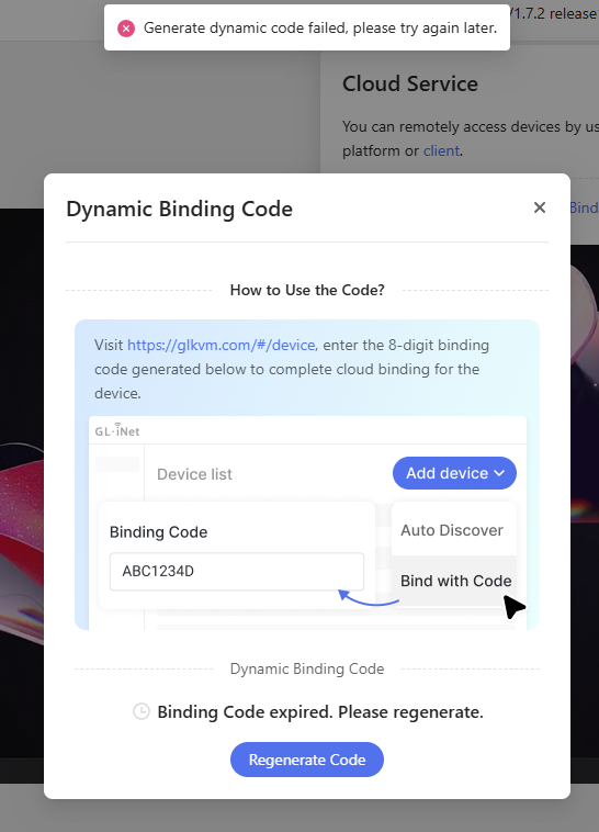

Checking cloud service status
Recently got the comet pro
Not super familiar with the IT world, just wanted try out this cool sounding device
Device says that it is checking cloud service status constantly. I tried to login into the device locally and when I try to bind it there, it gives me an error saying, “Generate dynamic code failed, please try again later.”

This is usually due to the device not being connected to the cloud platform. You can access the terminal via Toolbox->Terminal, enter `logread|grep cloud|grep err` and press Enter to see what error messages are displayed.
You can also export the log files here and send them to me.
Well I let it just sit overnight and it seems to have sorted itself out. Thanks for the effort though!
