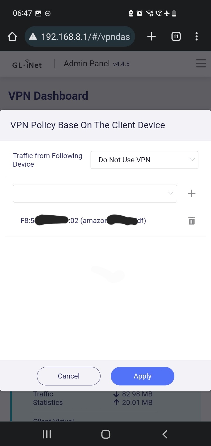

Not sure if you implemented in the same way. I found a brilliant setting to accomplish this without having to fiddle with routing tables:
Just set the router Proxy Mode (inside the VPN config screens) to “Based on the client device”.
Then you set it to exclude the particular device based on MAC address.
I implemented bypassing through routing tables as I have multiple WireGuard connections running on my router simultaneously.
Glad you were able to find a solution though!
