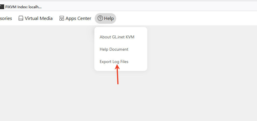

show us the debug log

Here's the system log. I've tried power cycling the device, reseating the USB C cable running to the ATX board. When the machine is on I do see a solid cyan coloured light.
According to the logs, there is indeed no ATX device connected. Could you try using another USB-C to USB-A cable for the connection?
