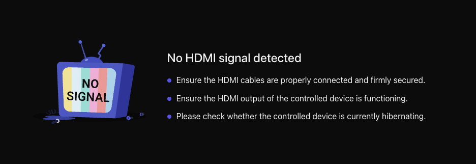

Hi all,
I have connected Comet to my new Mac Mini, and direct connection to screen (via Comet) works fine. However, when I connected via glkvm network, the signal cannot be detected and no screen data is shown. Any help is appreciated. Thank you.
Hi all,
system_logs_20260613_001958.zip (97.2 KB)
Here it is. Thanks!
upgrade to the newest firmare , old firmware can’t support fps higher than 60
