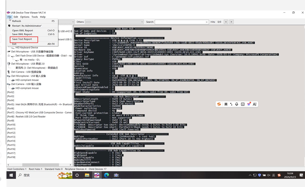

Could you please share the USB topology/tree from both your host (controlling) PC and target (controlled) PC? Here is how you can capture it:
For Windows: Please download USB Device Tree Viewer. You can refer to the attached screenshot to export the log (File -> Save Report...) and send it to us.
For macOS: Go to Apple Menu  -> About This Mac -> System Report -> Hardware -> USB.
Additionally, if you can temporarily downgrade to version 1.9.2 where it worked properly and provide a comparison log or screenshot, it would help us pinpoint and fix the issue much faste.
