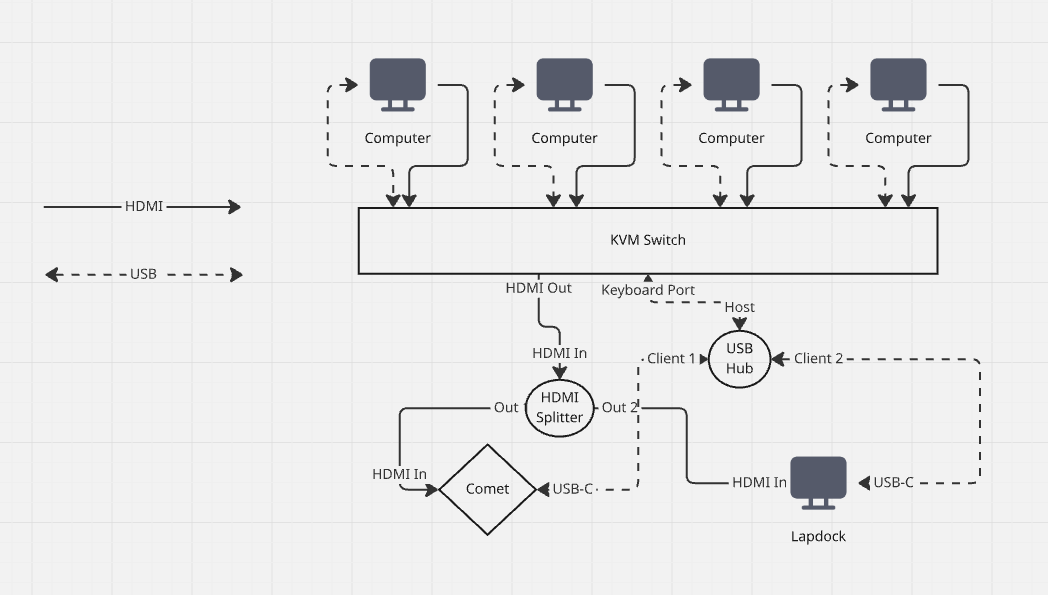

Here's a quick Miro showing the setup, hope it helps! The HDMI splitter and the USB Hub are connected to the KVM switchbox as a host, then both are connected to the Comet and the Lapdock. The best part is that by disabling mass storage on the Comet I can still use hotkeys from both to switch KVM inputs!
I'm curious, after connecting to this HOTKEY KVM SWITCH, will the mouse still work?
It does for both! Even though the port is labeled for a keyboard and there's a dedicated mouse port (along with a "hub" port), both the Comet and Lapdock allow both keyboard and mouse access to my Windows machine (the other three are Linux machines and I don't use a GUI on them).
