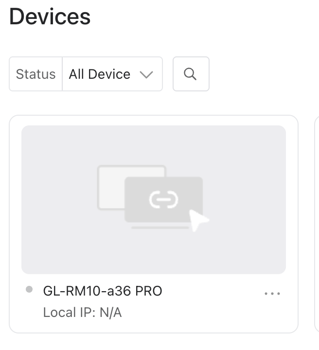

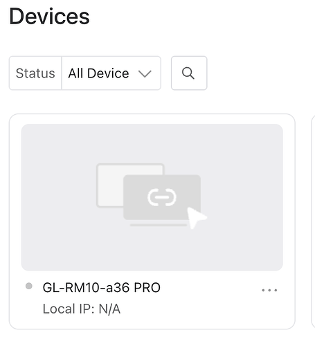

now i’m facing the issue where, despite the device being connected, is not visible from the cloud:
system_logs_20260303_153424.zip (59.7 KB)

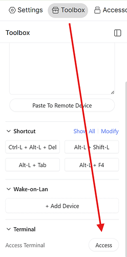

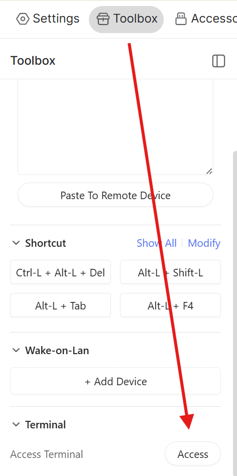

Please try entering this command and see if the problem persists.
/etc/init.d/S98multi-wan restart
