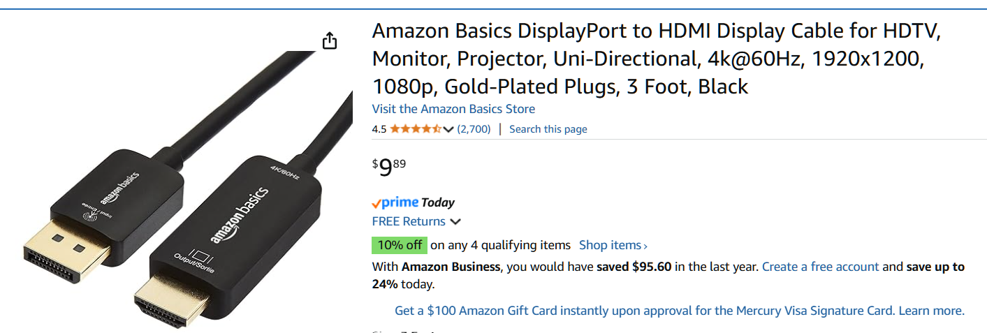

I am using this one from Amazon. This cable works fine as i tested it already.
OK, got it. Could you pls share your log file to me? And before that pls connect your DP to hdmi cable between the comet and your controlled device.

We test the Displayport to HDMI Converter like this. didn't test the cable. Will buy and test this amazon cable.

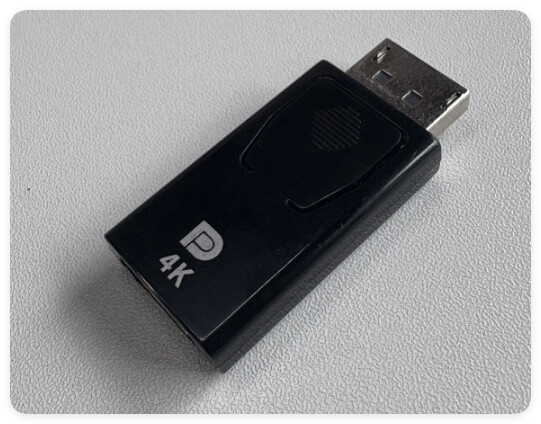

Update: I purchased this adapter as another test, along with a new HDMI cable. Comet still doesnt see any signal.

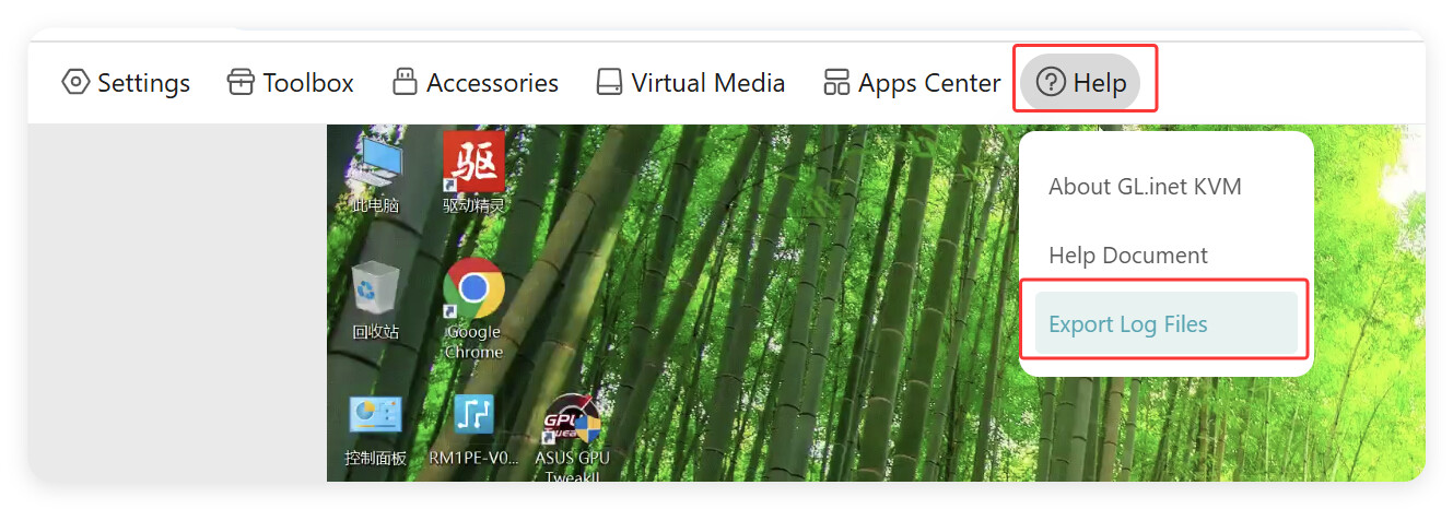

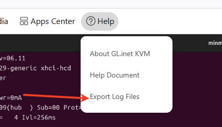

maybe you can export log to us .And we can see what the problem is
I do some reserch about DP to HDMI adapter. there's active/passtive adapter. the active one will get a better compatibility. I just don't which one you've got.

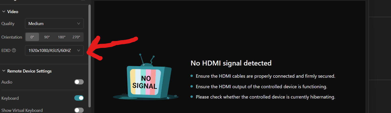

And I saw the active adapter will support higher resolution. So I wonder if you can change the resolution of your DP out to 1920x1080 for test?

I set it to this resolution in the app.

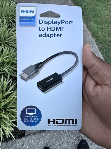

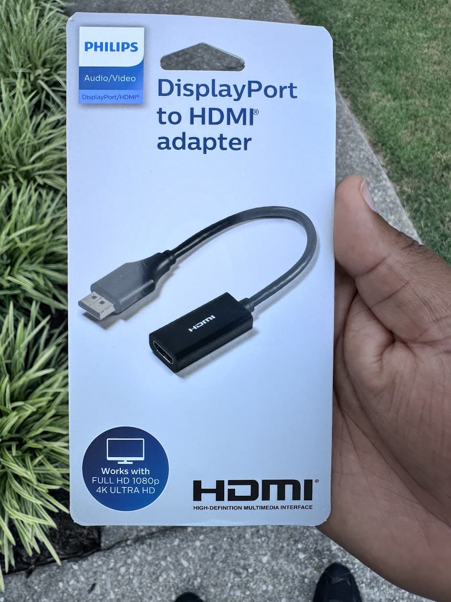

@alex_zheng I tried yet another DP_HDMI adapter and now its working!!
From my understanding, the cables can be active or passive but the adapters are not.

I tried yet another DP_HDMI adapter and now its working!!---------->good news, could you please share the model to us ? You just change the adapter,and it works?
