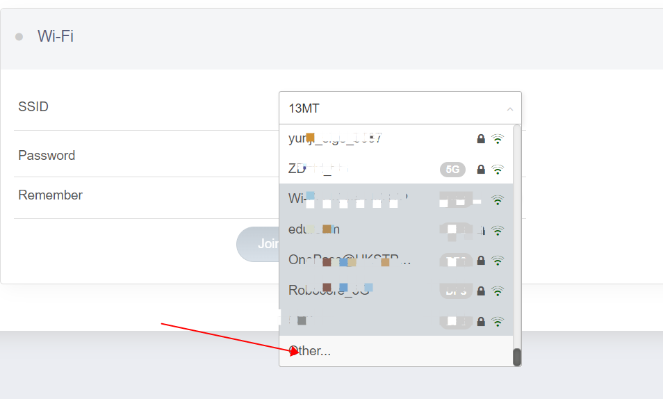

Hi, there is no button to enter a SSID not within the app not with the web interfaces of the router.
There is no special button.
On the GL.iNet Internet page, click “Scan” in the Repeater section, as if you are going to connect to another SSID. When the page comes back with the wifi list, click the SSID listbox and scroll down to the bottom to select “Other…”. You will then be able to manually enter the new SSID, Wi-Fi Security, Password and enable “Remember”.
Hopefully, when you click the “Join” button, it will save the new information without changing/disconnecting from the existing SSID.
Make sure that Repeater Options - “Auto scan and re-connect” is Enabled.
You have it here
many thank ok i was using all the time an apple smartphone it seems the web interface on chrome is not working properly i just see the scan progressbar going to 100% and then nothing more. With a laptop it is ok right now.
