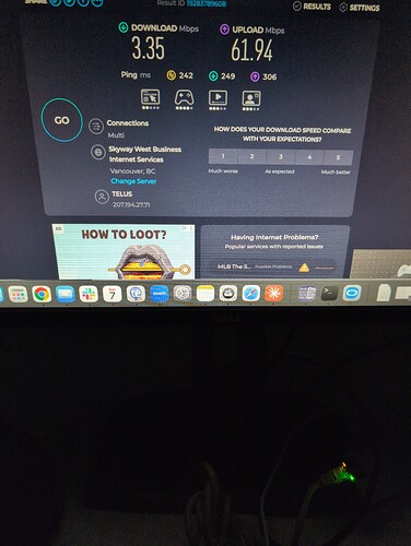

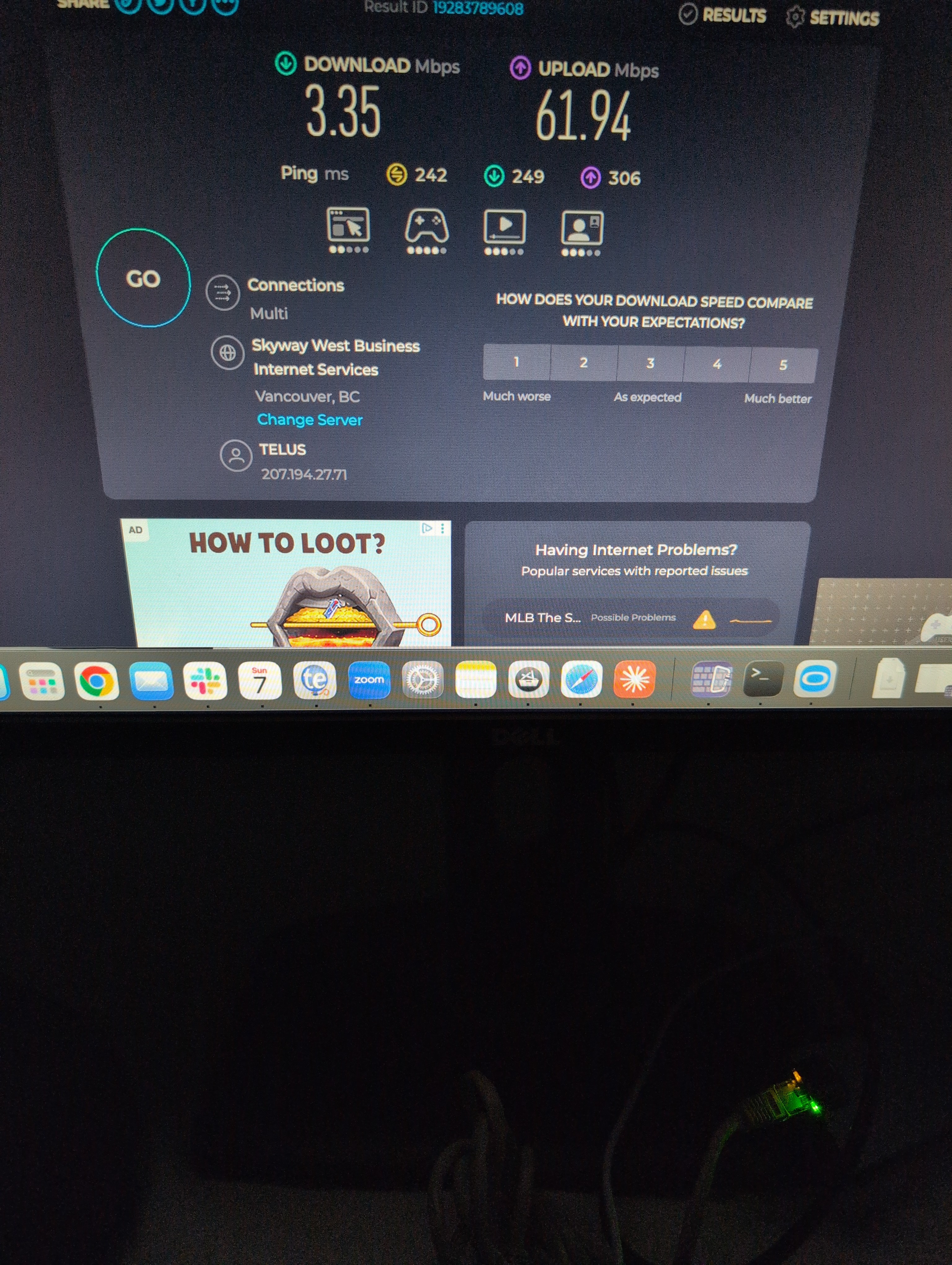

I actually went back to my parent's house since I was in vacation when I posted my recent horrible speed experience, and I feel that it's very weird that I have a super upload speed but my download is sacrificed heavily, although it makes me do my work and it doesn't lag as it used to as I was getting 0.02MB sometimes, and to note that earlier when I started my shift my download speed was always 30 MB as well which is super acceptable.
I'm not sure if it's my actual dongle since I have a aftermarket that I bought here and my ethernet cable is not that greats maybe I should test with Wi-Fi but even then what do you guys think.
