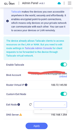

After a long discussion with Telus, an agent was too kind to look this up for me and after consulting with his support they have advised him to add an add on on my account that goes by the name of “APN P2P Gaming” for $5 which I of course accepted.
Although both the router and the signal were rebooted, I still have a private IP address which was frustrating to be honest.

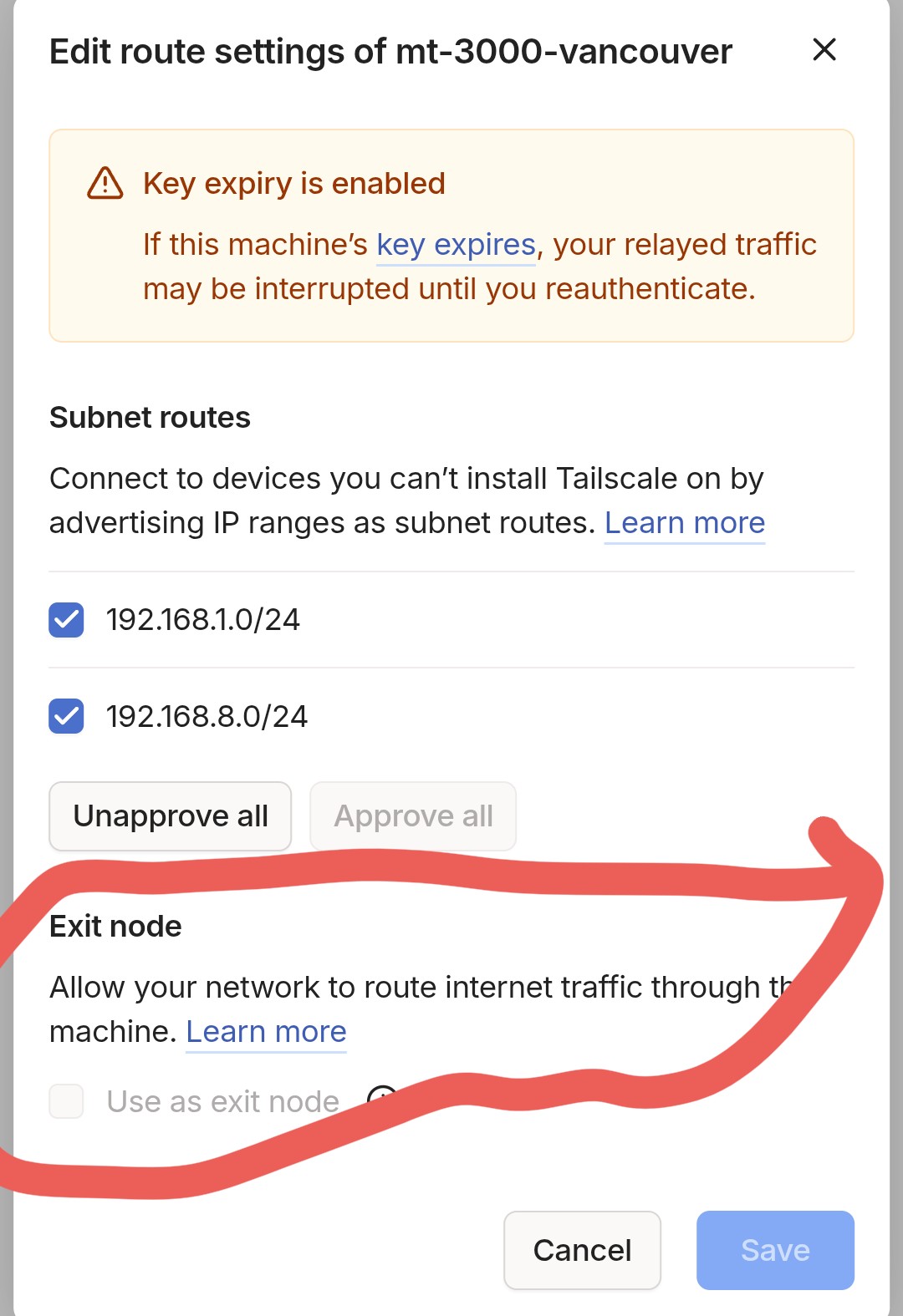

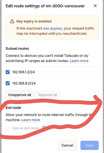

At this point I am considering tailscale And I started configuring it, looks pretty easy however my “use custom node” Button is grayed out and I can't activate it, I'm thinking it's a permission issue or something I tried a couple of things but it didn't work.
I would appreciate it if you guys could help me “ungray” It, I've tried some SSH commands but it still didn't work.

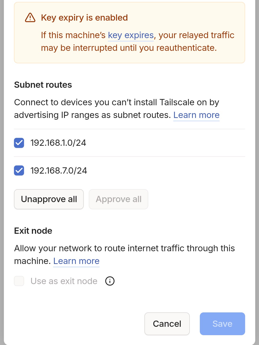

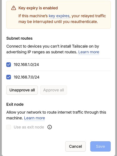

What I meant by exit node is when I'm trying to configure tailscale it's grayed out so I understand that I need my ip address to go through that tunnel which is the exit node. However, it says change is not allowed so I'm thinking I need to twist things a little bit more.
Also, I'm not sure if I need to install tailscale on my Windows computer or is it okay just to go to the admin console on my Google Chrome browser and have things run from there.

Our devices currently do not support advertising themselves as a Tailscale exit node.
You can refer to the following guide to configure it manually:
Alternatively, you can install a plugin provided by a forum user:
Amazing! There's even a plug-in to avoid a DNS leak! Thank sitting down once I'm out of the airport and I will be configuring my tailscale then with SSH have my travel router exit note setup from my home router.
Once the exit node is configured then, that's it right? It will just act as the wireguard server and clients that I initially wanted to use, right?
Thank you again for your assistance.
Yes, once the router is configured and running as a Tailscale exit node, it will take on a role similar to a WireGuard server.
After that, you just need to run Tailscale on client devices—such as another our router, PC, or mobile phone—and select it as the exit node to route all traffic back to your home network.
For client-side setup, here is our router configuration guide:
For other client devices, please refer to Tailscale’s official guide:
