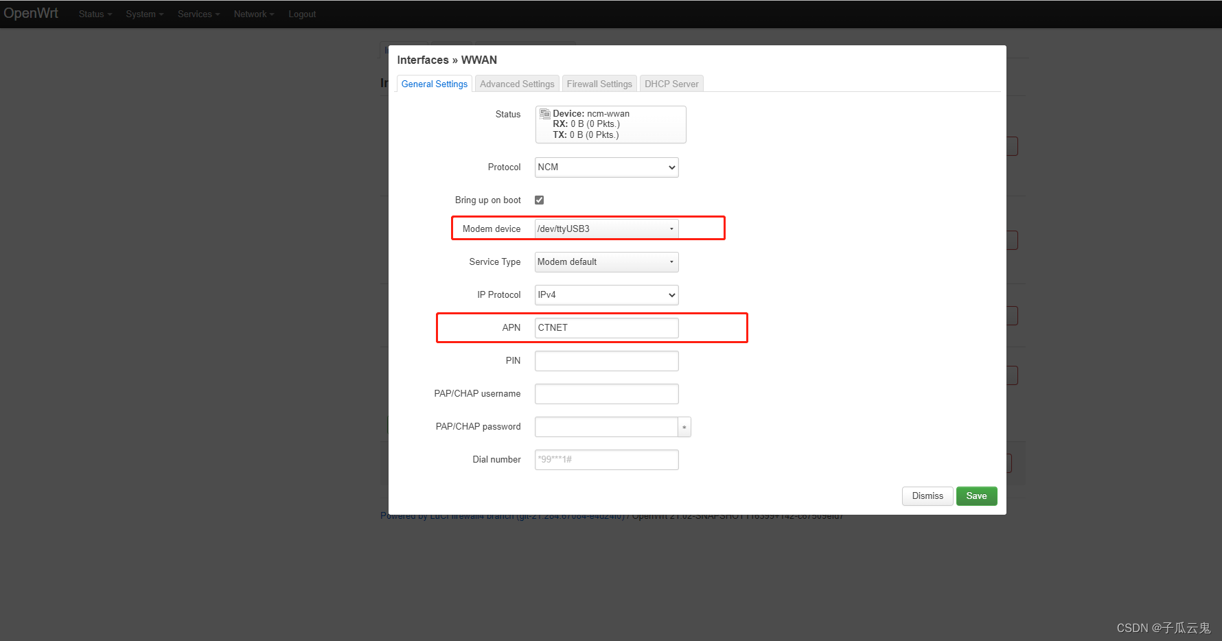

GL firmware did not support the RM5000U, it is not Qualcomm modem, so probably it cannot use QMI protocol and recognized as modem on GL router.
  1. Please try installing the plugin ncm, and use ncm to dial in the Luci
  2. If AT+QCFG="usbnet" is supported for RM500U, you can connect it the PC and change the working mode of the modem AT+QCFG="usbnet",0, and plugin the GL router to see if it can be recognized as modem, and use ppp to dial.
If above ways does not work, probably only be connected via Tethering.
