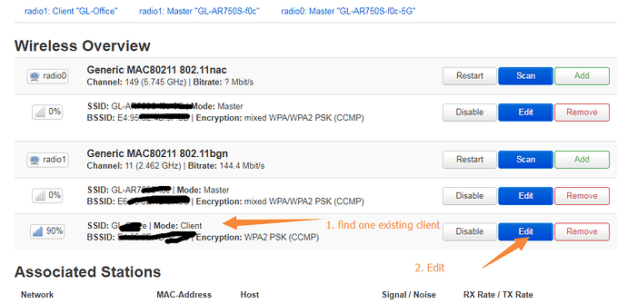

Here is the guide of connecting to a hidden network.
First, you need to know if your Hidden WiFi network is 2.4G or 5G.
Then you have need to connect to an existing non-hidden SSID first. This step is set up everything for you.
After you have done this, do the following:
  1. Advanced settings (luci) → Network → wifi,
    Find your current client, click Edit
  1. Input your hidden SSID info.
  1. Finally, click save & apply
