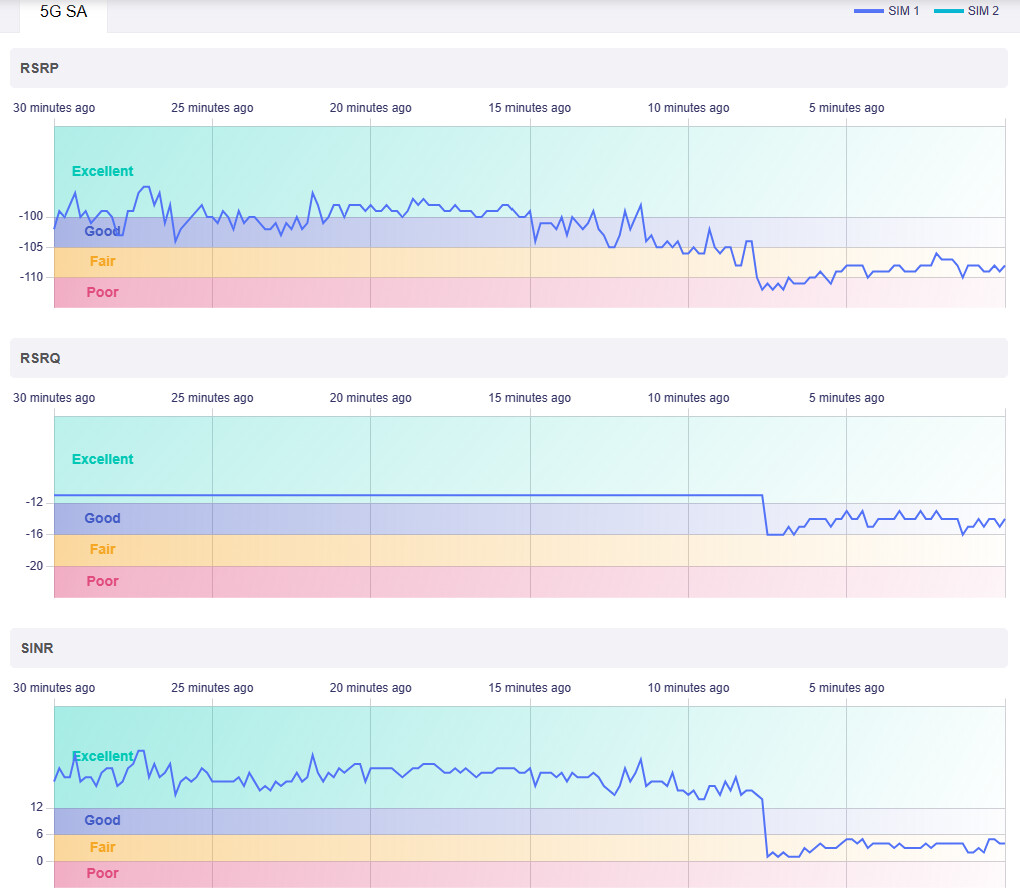

@mondokkia Have you checked the signal quality in the cellular history page? Does it show negative values and not display properly using the RM520NGLAAR03A03M4G_01.200.01.200 Firmware? That is what it did for me.
@gainestr My history looks normal enough though the signal dropped in the last 10 mins as the router changed bands
@gainestr Checking the router again showed it switched to 5G NSA and the cell history has become spotty. Is that what you’re seeing?

After I downgraded from 2024-02-01 to 2023-07-25, I noticed disconnection issues almost immediately. The connection was relatively stable for about 10 minute increments, at first, and then became extremely unstable, to the point where I would have connection for 30 seconds and then a disconnect.
I upgraded again to 2024-02-01, this is the most stable version for me.
I tested VPN capabilities and found that these actually work fine. I also tested IPv6 and that seemed fine.
It seems like 2024-02-01 is the best bet - I’m sticking by my original post.
