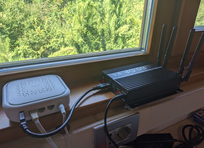

Hello, I was able to use my EM160R-GL with a box similar to the one you posted, it’s slightly larger to support 4 antennas (so that every RF connector is correctly addressed on the EM160R-GL, remember to never power up anything without every antenna connected)
I’ve flashed ROOter and for the list of supported modems you need to refer to them, not GLiNet since ROOter handles the establisment of the MBIM connection over USB and other AT commands to know modem’s status such as signal quality, temperature, APN settings, temperature etc.
Here’s a picture:
