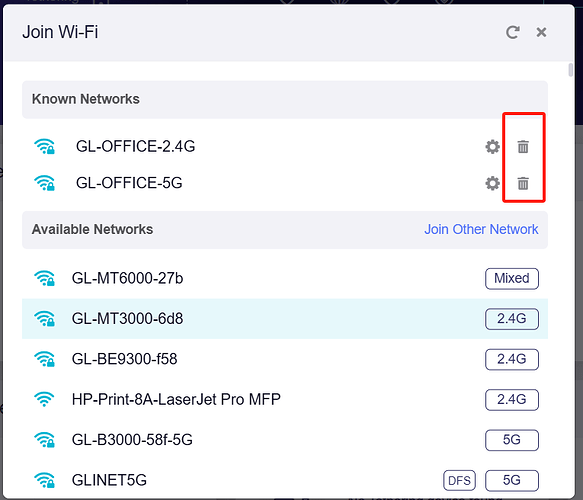

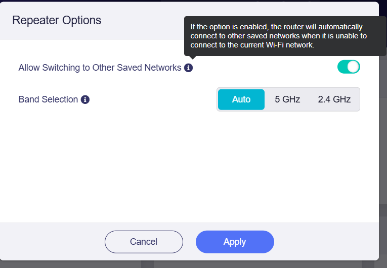

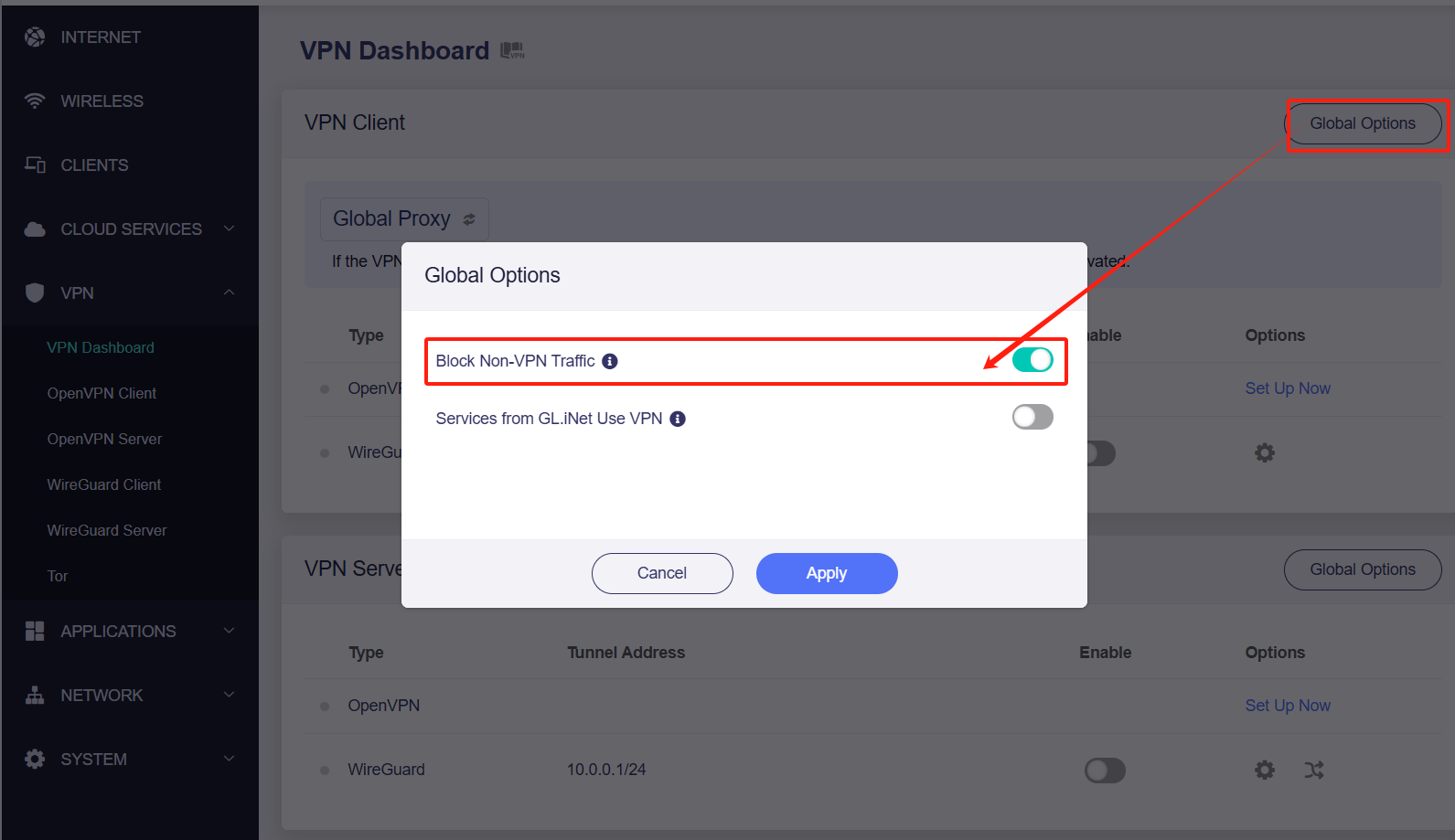

You can set up a VPN client on the first router, and then enable block non-vpn. Set the second router to extender mode and connect to the WiFi of the first router. This can prevent VPN leakage.
Note: You can clear the WiFi connection record of the second router to avoid automatically connecting to other WiFi when the upper network is disconnected.
