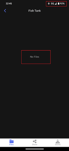

No, you cannot access files via Goodcloud, afaik.
Use VPN (Wireguard) or ZeroTier for this.
FYI: “GoodCloud” is a WG based service.

I can connect to it on my mobile phone with the GL inet app as long as im connected to the wifi, but if I turn the wifi off and use mobile data, I can still see the USB stick and folders, but when I open a folder it shows no files, ive added a couple of picts below showing the same thing, but one is on mobile data and one is on wifi, it seems more like a permission thing to me, just dont know how to fix it.

It is only WG based if you establish a site-to-site VPN connection between two GL.iNet routers. And then the WG tunnel only exists between these devices. Otherwise GoodCloud is only HTTP and probably WebRTC for the remote admin portal.
Oh, I can see that now. I was under the impression all comms were tunnelled. Huh.
