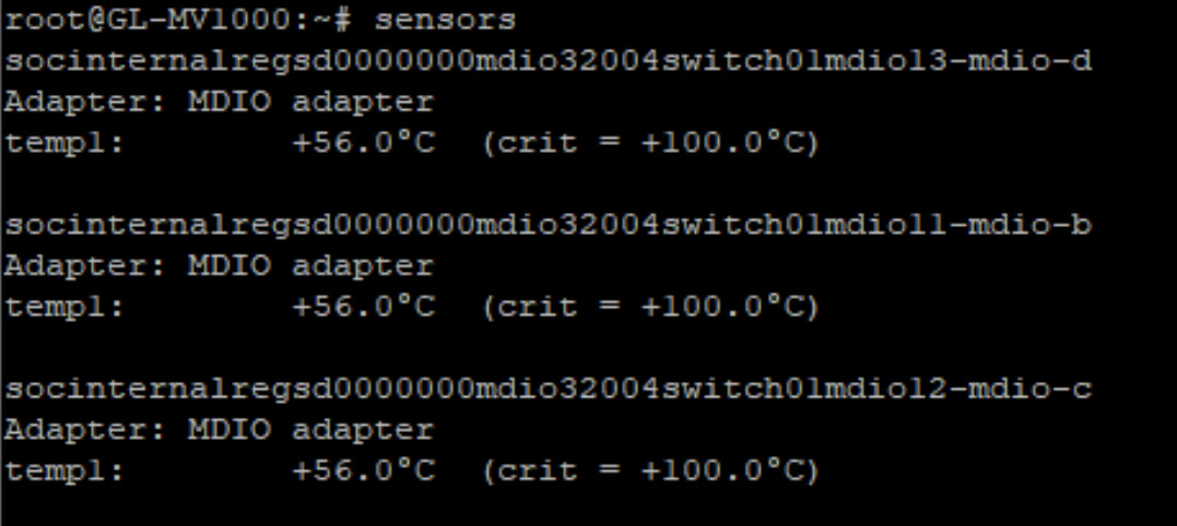

I noticed that the MV1000 gets pretty warm. Does anyone know if the firmware throttles the CPU when it gets warm? Do you guys cool it down with a fan?
