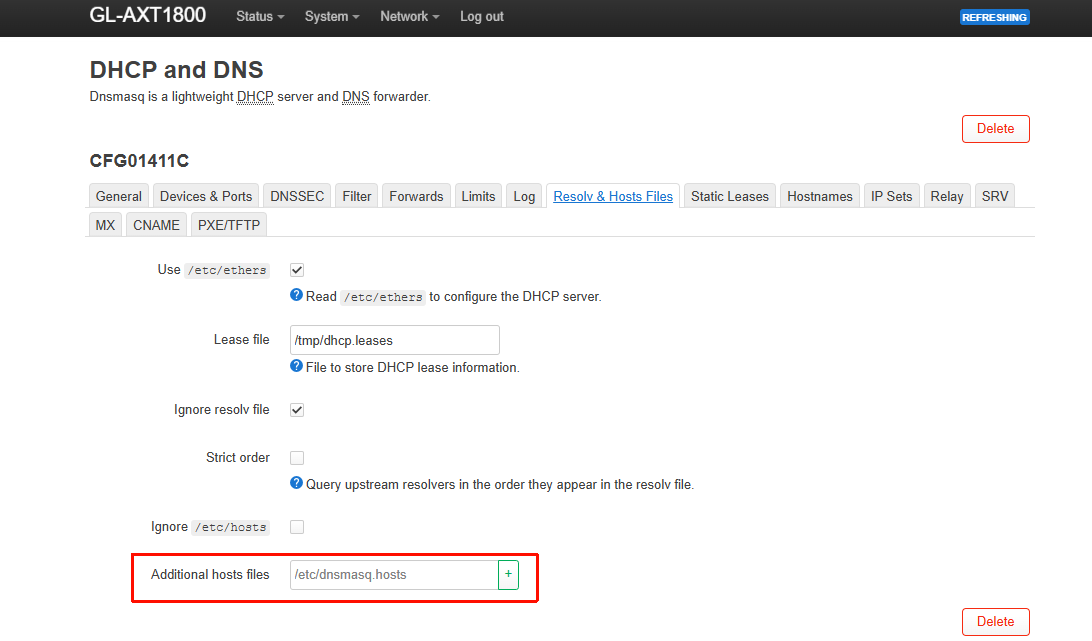

I also need a custom hosts file that contains the parameters for add-blocks. What is recommended here?
Support for /etc/dnsmasq.d/ is implemented by adding the following configuration to /etc/dnsmasq.conf. You can do the same thing in OpenWRT:
conf-dir=/etc/dnsmasq.d/,*.conf
Custom Hosts can be specified directly within the LuCI.
