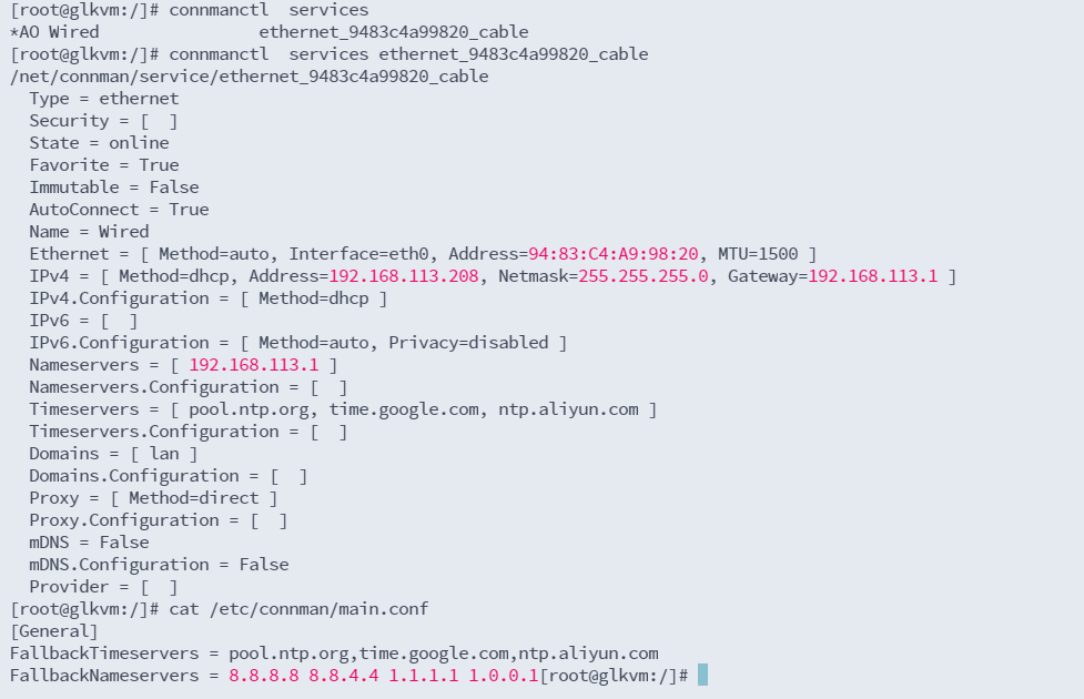

Even when I disable to daemon the GLKVM still sends out NTP requests.
[root@glkvm:~]# sh /etc/init.d/S49ntp stop
Stopping ntpd: OK
[root@glkvm:~]# ps -ef | grep -i ntp
root      300 1635  0 08:35 pts/0    00:00:00 grep -i ntp
08:36:27.353879 94:83:c4:bb:17:1f > 64:62:66:21:c8:41, ethertype IPv4 (0x0800), length 90: (tos 0x10, ttl 64, id 61055, offset 0, flags [DF], proto UDP (17), length 76)
    192.168.69.60.35001 > 192.168.69.5.123: [udp sum ok] NTPv4, Client, length 48
	Leap indicator: clock unsynchronized (192), Stratum 0 (unspecified), poll 10 (1024s), precision 0
	Root Delay: 0.000000, Root dispersion: 0.000000, Reference-ID: (unspec)
	  Reference Timestamp:  0.000000000
	  Originator Timestamp: 0.000000000
	  Receive Timestamp:    0.000000000
	  Transmit Timestamp:   3969866187.089426059 (2025-10-19T12:36:27Z)
	    Originator - Receive Timestamp:  0.000000000
	    Originator - Transmit Timestamp: 3969866187.089426059 (2025-10-19T12:36:27Z)
08:36:29.351801 94:83:c4:bb:17:1f > 64:62:66:21:c8:41, ethertype IPv4 (0x0800), length 90: (tos 0x10, ttl 64, id 61620, offset 0, flags [DF], proto UDP (17), length 76)
	  Transmit Timestamp:   3969866189.088947825 (2025-10-19T12:36:29Z)
	    Originator - Transmit Timestamp: 3969866189.088947825 (2025-10-19T12:36:29Z)
08:36:33.355240 94:83:c4:bb:17:1f > 64:62:66:21:c8:41, ethertype IPv4 (0x0800), length 90: (tos 0x10, ttl 64, id 62458, offset 0, flags [DF], proto UDP (17), length 76)
	  Transmit Timestamp:   3969866193.089769950 (2025-10-19T12:36:33Z)
	    Originator - Transmit Timestamp: 3969866193.089769950 (2025-10-19T12:36:33Z)
08:36:33.355422 64:62:66:21:c8:40 > 94:83:c4:bb:17:1f, ethertype IPv4 (0x0800), length 90: (tos 0xb8, ttl 64, id 5340, offset 0, flags [none], proto UDP (17), length 76)
    192.168.69.5.123 > 192.168.69.60.35001: [bad udp cksum 0x0bdc -> 0x4062!] NTPv4, Server, length 48
	  Originator Timestamp: 3969866193.089769950 (2025-10-19T12:36:33Z)
	  Receive Timestamp:    3969866193.089769950 (2025-10-19T12:36:33Z)
	    Originator - Receive Timestamp:  -0.000000000
	    Originator - Transmit Timestamp: -0.000000000
08:36:38.351975 94:83:c4:bb:17:1f > 64:62:66:21:c8:41, ethertype IPv4 (0x0800), length 90: (tos 0x10, ttl 64, id 63465, offset 0, flags [DF], proto UDP (17), length 76)
    192.168.69.60.37914 > 192.168.69.5.123: [udp sum ok] NTPv4, Client, length 48

Either I have something configured incorrectly on the GLKVM, or the GLKVM is using some other configuration file other than /etc/ntp.conf or a there is another NTP daemon running. Either way, it seems like the GLKVM is not playing well with others and polluting the network with NTP requests. I have tried turning off the NTP daemon, using NTPDATE 192.168.69.5 to update the clock, then reenabling the NTP daemon. I also notice the NTPQ command is not available to check which servers the GLKVM is using and their status.
Update:
Not sure if this is something, but appears GLKVM might be using connman.
[root@glkvm:~]# connmanctl technologies
/net/connman/technology/ethernet
  Name = Wired
  Type = ethernet
  Powered = True
  Connected = True
  Tethering = False
  TetheringFreq = 2412
Timeservers list is blank.
[root@glkvm:/usr/sbin]# connmanctl clock
  Time = 1760879356
  TimeUpdates = auto
  TimezoneUpdates = auto
  Timeservers = [  ]
  TimeserverSynced = False
There is an extra “;” in the timeservers entry

Update 2:
I had to disable the ntp daemon, remove the iburst option, restart my NTP server to clean any cashed rate limit exceedance, manually run the ntpdate 192.168.69.5 command to sync the GLKVM clock, then reenable the ntp daemon. That’s the only way I could stoop the GLKVM to stop continuously sending NTP requests.
[root@glkvm:~]# connmanctl clock
  Time = 1760886761
  TimeUpdates = auto
  Timeservers = [  ]
  TimeserverSynced = True
But as soon as I reboot the GLKVM, the clock is not synchronized and the GLKVM continuously sends NTP requests.
  Time = 1760887113
  TimeUpdates = auto
  Timeservers = [  ]
So it seems like the GLKVM continuously sends NTP requests (every 2 seconds) if the GLKVM clock is not synchronized yet, which the NTP sever will detect rate limit exceedance and send KOD. This is even with the NTP daemon not running. Seems like a bug in the GLKVM implementation of NTP.

Looks like 1.7.0r2 removed the NTPD daemon altogether, so you have to use CONNMAND to sync the clock. I think this aligns with the developer feedback posted on my GitHub Issue
GOOD NEWS
Because there are no longer two daemons running trying to sync the clock, forcing the NTP server to respond with KOD, CONNMAND can sync the clock.
MITIGATION UPDATES
If you implemented my suggested mitigation above, you have to configure CONNMAND to auto and remove the IPTABLES rule that blocks NTP requests not originating from port 123

UNKNOWN
CONNMAND is not using public NTP servers in my case, so not exactly sure where it is getting my local NTP server IP from. Although, I do have my local NTP server defined in my pfSense DHCP server, so perhaps it is retrieving it from there.
connmanctl clock
  Time = 1762857000
  TimeUpdates = auto
  Timeservers = [  ]

If your DHCP options specify an NTP server, ConnMan should use the one provided by DHCP. Otherwise, it will use these fallback servers shown in the image.
I tested this on my Comet. DHCP-provided Timeserver does not show up in the connmanctl output.
Would this not be a lot simpler to add the ntp servers in the gui – none of these work arounds will persist. DHCP option 42 still does not work either. Since NTP is important for most things - assuming we will sync to external servers is short sighted.
Yes it would.
GL‑iNet removed CONNMAND’s time‑sync mechanism in recent firmware because ConnMan does not honor NTP Kiss‑of‑Death (KOD) packets, ignores rate‑limiting, and can end up hammering public NTP servers with rapid repeated requests.
For the KVM products like the RM1, it now uses only NTPD, which does not use a DHCP configured NTP server. Thus, if you want to override the default public NTP servers, you have to add a script to the /etc/kvmd/user/scripts folder to step on the default /etc/ntp.conf file. Doing it that way will persist across firmware upgrades.
I’ve read other products are migrating to chrony
This situation is so stupid. In the past, gl.inet (minmie) said they did not want to include it in the GUI because somehow that would “confuse users”. How that is any more confusing than setting a DNS server or anything else, I can’t understand. Just give users an option of leaving it on “auto” or a manual override. Forcing people to people to hack custom scripts into the system just to set NTP servers is idiotic.
