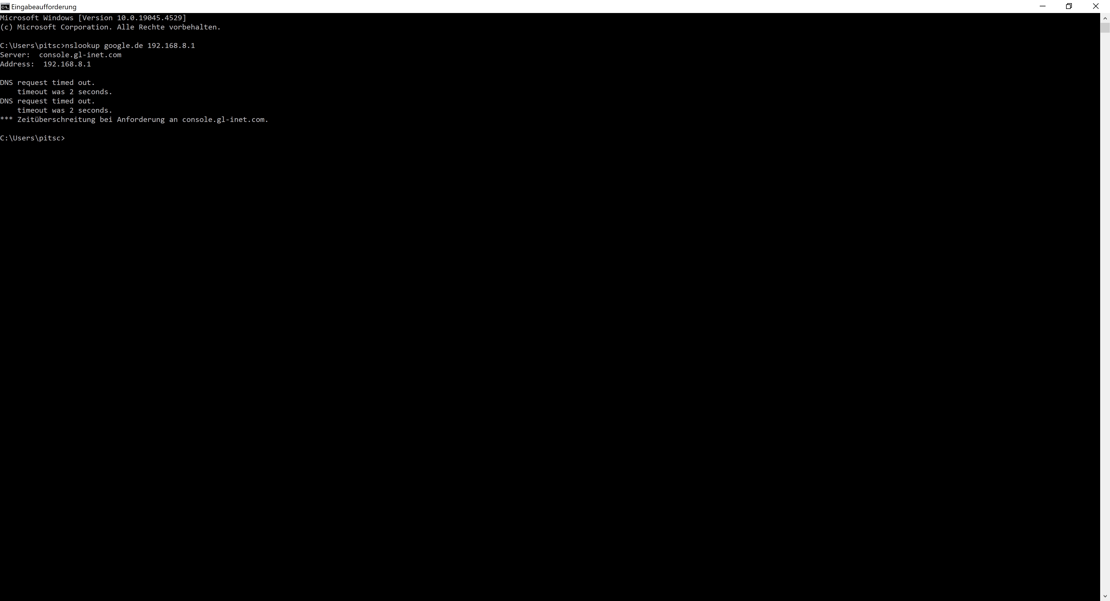

Could you please execute nslookup google.de 192.168.8.1 while VPN is connected?
Ok, the issue is that your DNS server is failing.
I'm not quite sure how you installed CyberGhost. Is it WireGuard or OpenVPN?

The only thing I can tell for sure: DNS resolution on your MT300 is failing as soon as you are connected to CyberGhost. I am not sure why this happens, but maybe it will help you to figure out what to change.
Thanks for your help.
Maybe another member of the forum who works with cyberghost will get in touch.
The only strange thing is that everything works on the TV, but the devices (tablet, phone and PC) don't connect
Just out of curiosity, please try this.
Go to Network > DNS and change your DNS to - mode: manual and select cloudflare for example, click apply.
Now change back to automatic and apply.
See if that helps.
