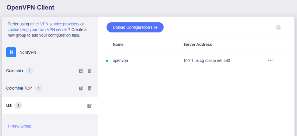

I bought a GL-A1300 router and I am configuring CyberGhost VPN. I have uploaded the configuration and I see in the VPN dashboard that it seems to be connecting fine, however I cannot connect to internet when the VPN is running.
This router is connected to a Xfinity router. In the Xfinity router I configured two ports to be forwarded, 1194 and 51820.
I have zero experience configuring this, so any help is appreciated.
