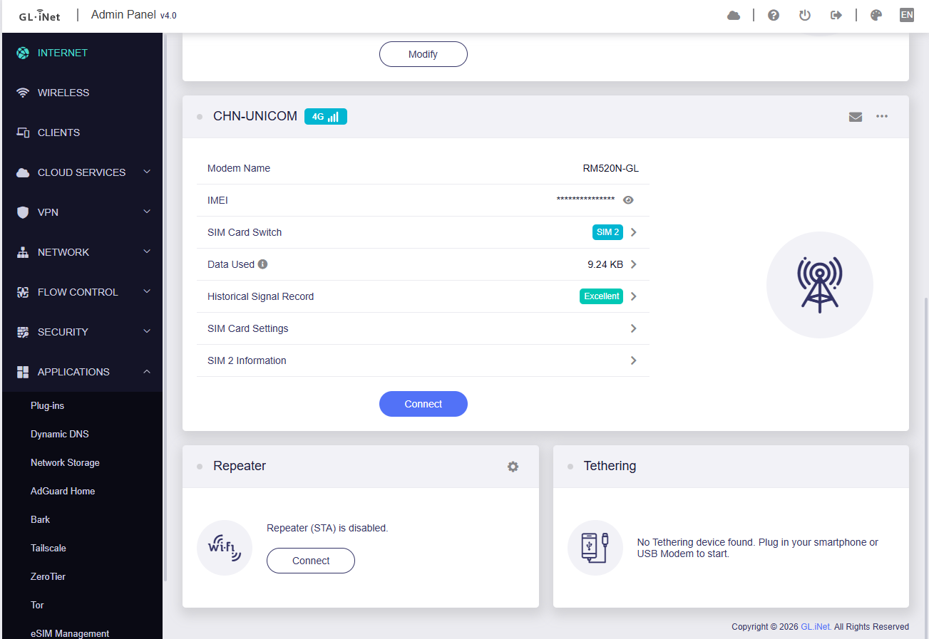

As for the Cellular 1, 2, and 3 issue, could you please provide some screenshots so that we can better understand the problem?
On our local side, the Admin Panel → Internet interface still only shows a single Cellular window:
