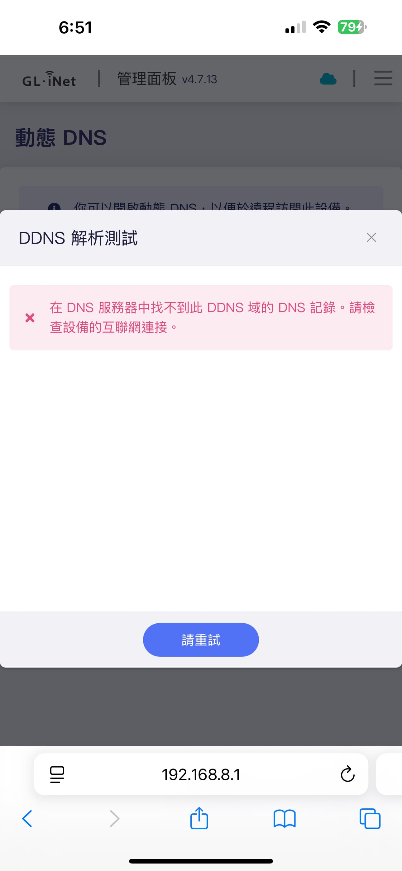

I just received my new Flint3, and happily set it up, yet the DDNS service is not working properly, showing no IP binded, could some one help please?

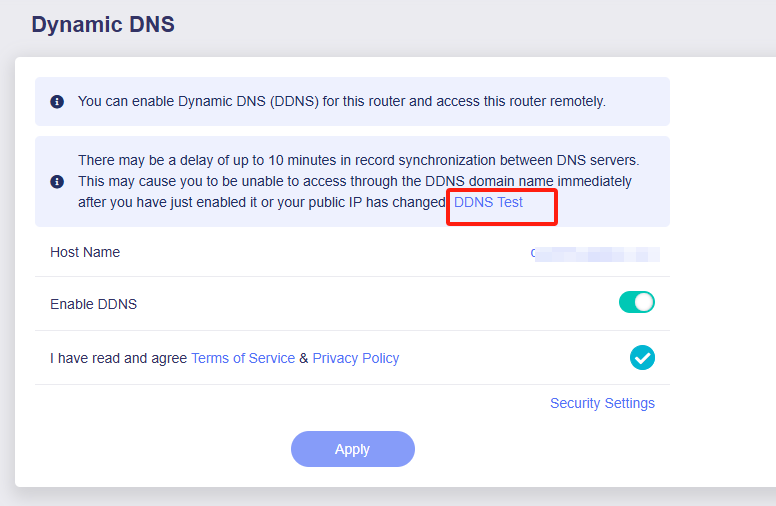

  1. Check WAN IP: Make sure it’s public (not 192.168.x.x).
  2. Verify DDNS Settings:
  3. Try to reconfigure and enable DDNS, then export the log for analysis
Let me know your WAN IP type and log errors and the router's version.

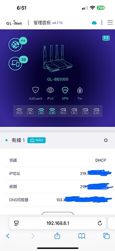

Same here for my flint 3...
mine is DHCP , WanIP for sure.

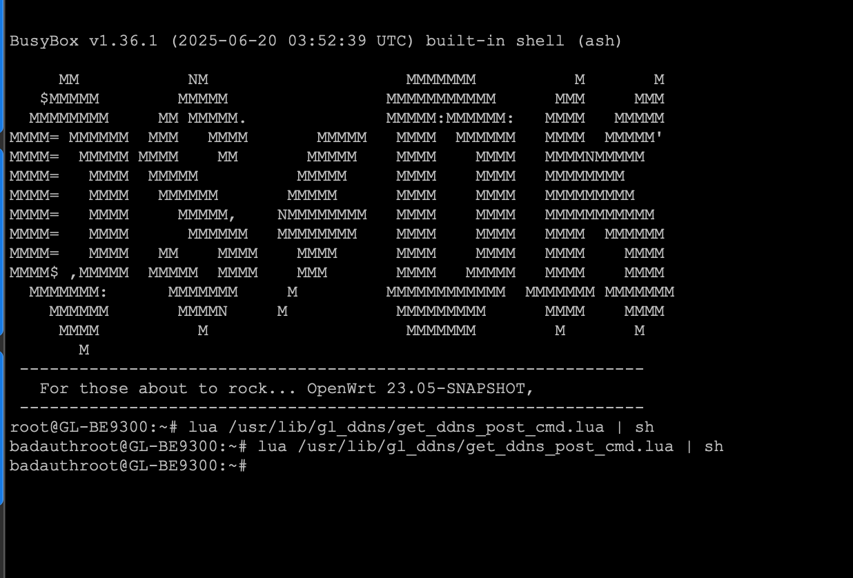

Please SSH to the router, and try to execute this command to check:
lua /usr/lib/gl_ddns/get_ddns_post_cmd.lua | sh

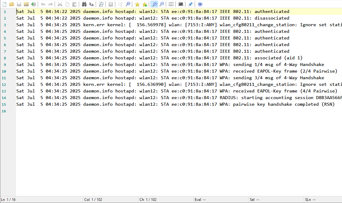

Tried to do so with a power recycle, but still no luck...
logread-2.tar (220.5 KB)
The syslog recorded only WI-FI information, and only 16 lines.
Please SSH to the router, and execute this command to check:
Please post the result here.

root@GL-BE9300:~# lua /usr/lib/gl_ddns/get_ddns_post_cmd.lua | sh
badauthroot@GL-BE9300:~#

Hi Guys,
I have the same problem with the DDNS, but on the Slate Plus. The problem has only been occurring for about 3 months. Before that it worked for a very long time without any problems. There were no changes to the network, apart from the regular FW updates (Stable)
If I activate DDNS, the service works for approx. 12-24 hours, after which it no longer works and I can only access the WAN IP directly via VPN.
If I deactivate DDNS on the router and reactivate it or switch it on again and confirm the terms of use, DDNS access works again for the above-mentioned time.
It seems to me that the problem here is not the Gl.inet DDNS service, but rather a problem in the firmware. The service itself is available.

Hi Bruce,
After I entered this command, no output shown...
It shows bad authentication.. same as mkne
