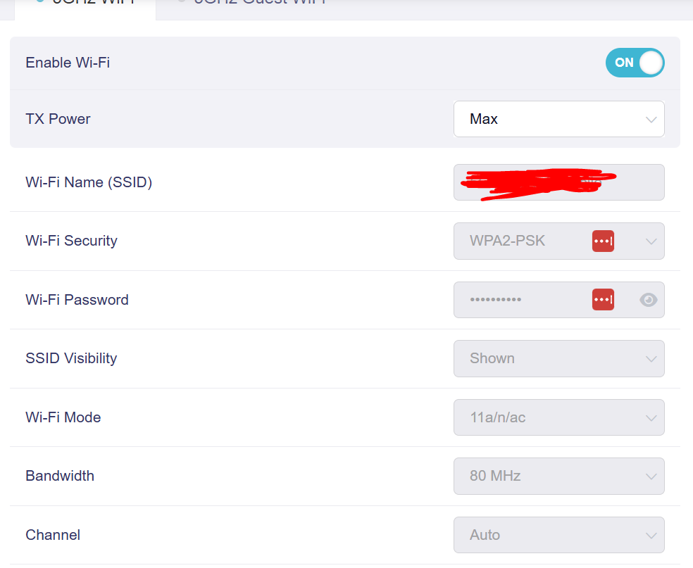

  2. None of my devices (laptops, mobile phone) see the WiFi network. They are enabled on the router. I've turned off and on, restarted the router a few times but no progress. The network is not visible. The internet works and I can connect laptop to the router through LAN.
Do you have any ideas re the second point? Why the devises can't see the network? I have not changed any settings and SSID Visibility is on.

  2. Are both 2.4G and 5G Wi-Fi networks not visible? Please log in to router to check the wireless config, make sure the SSID Visibility option is set to "Shown". In addition, you can set wifi channel to a different one to try.

With regard to SSID visibility, I have not changed any settings. I simply turned off the device in the evening, and in the morning after turning off both Wi-Fi networks were not visible.
