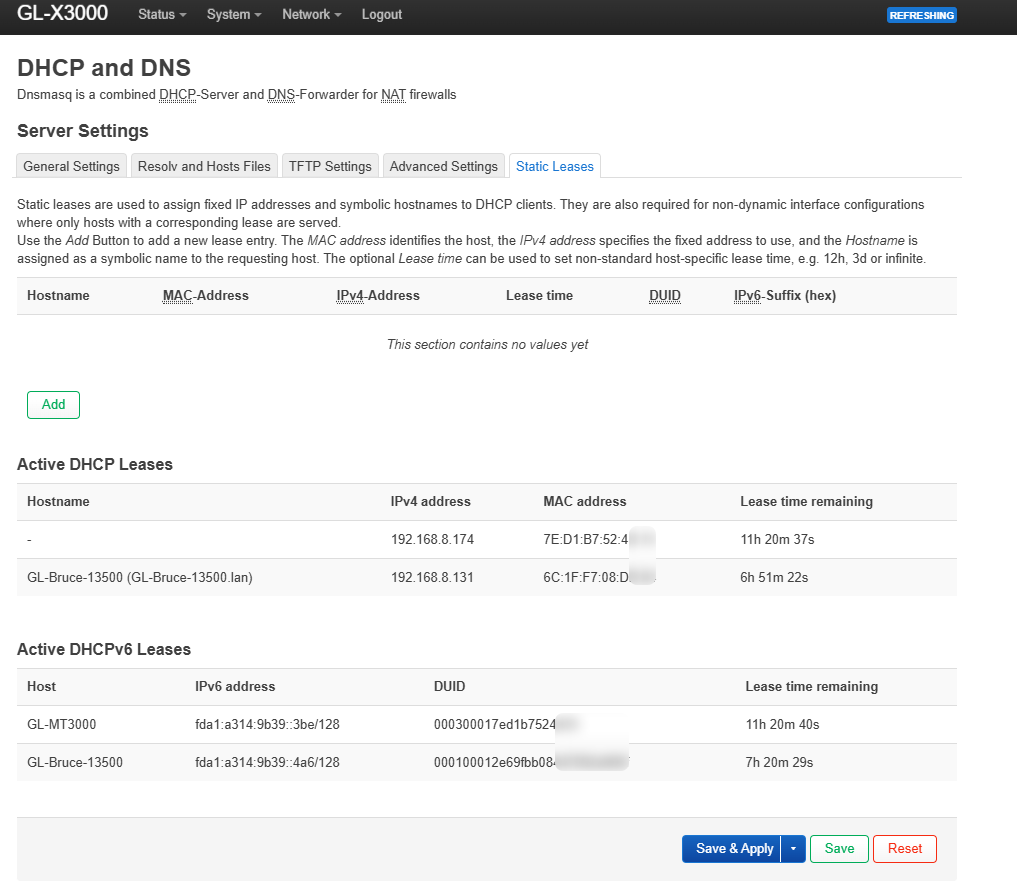

I've noticed (in LuCI) that although the IPv4 lease remain valid for the entire lease time (24H), the IPv6 lease tend to disappear from the list after about 10 minutes or less.
I ran a netcap to see if the client was releasing the IPv lease, but this never happened. The IP leases in OPNsense remain valid.
IPv6 traffic flows perfectly well even though the gateway apparently thinks that this address has been released, so this is a minor annoyance; not a usability issue.

The static lease is set for the default 24hrs.
When I force a lease renewal in OPNsense, I can see in the LuCI Network -> DNS and DHCP -> Static Leases that the IPv4 and IPv6 leases have been renewed (see below)
After a short time (compared to the lease time), the IPv6 lease no longer appears, even though there was never a "release" message sent from the OPNsense host (see below)

Sorry I miss this, this time I used X3000 v4.7.4 to try to reproduce it, and I didn't find that the IPv6 address would be released, during about 5h.
If the client does not actively send the released message, the GL firmware will not release the client's IPv6 address itself.
You can try SSH to the router and ping <OPNsense IPv6 address> to see if the ping will be interrupted.
