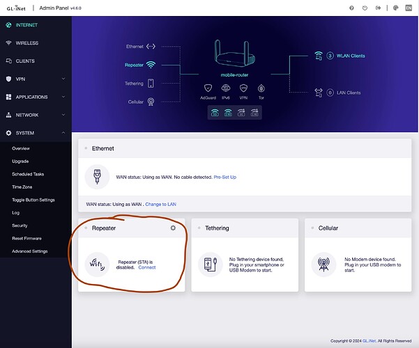

i just tried the latest snapshot:
Version4.6.0
Compile Time2024-04-22 17:20:52 (UTC+00:00)
The Router is working fine, but it displays something wrong. I am connected via wifi, but the status for the repeater is: “Repeater (STA) is disabled.Connect”.
Can you please fix that.

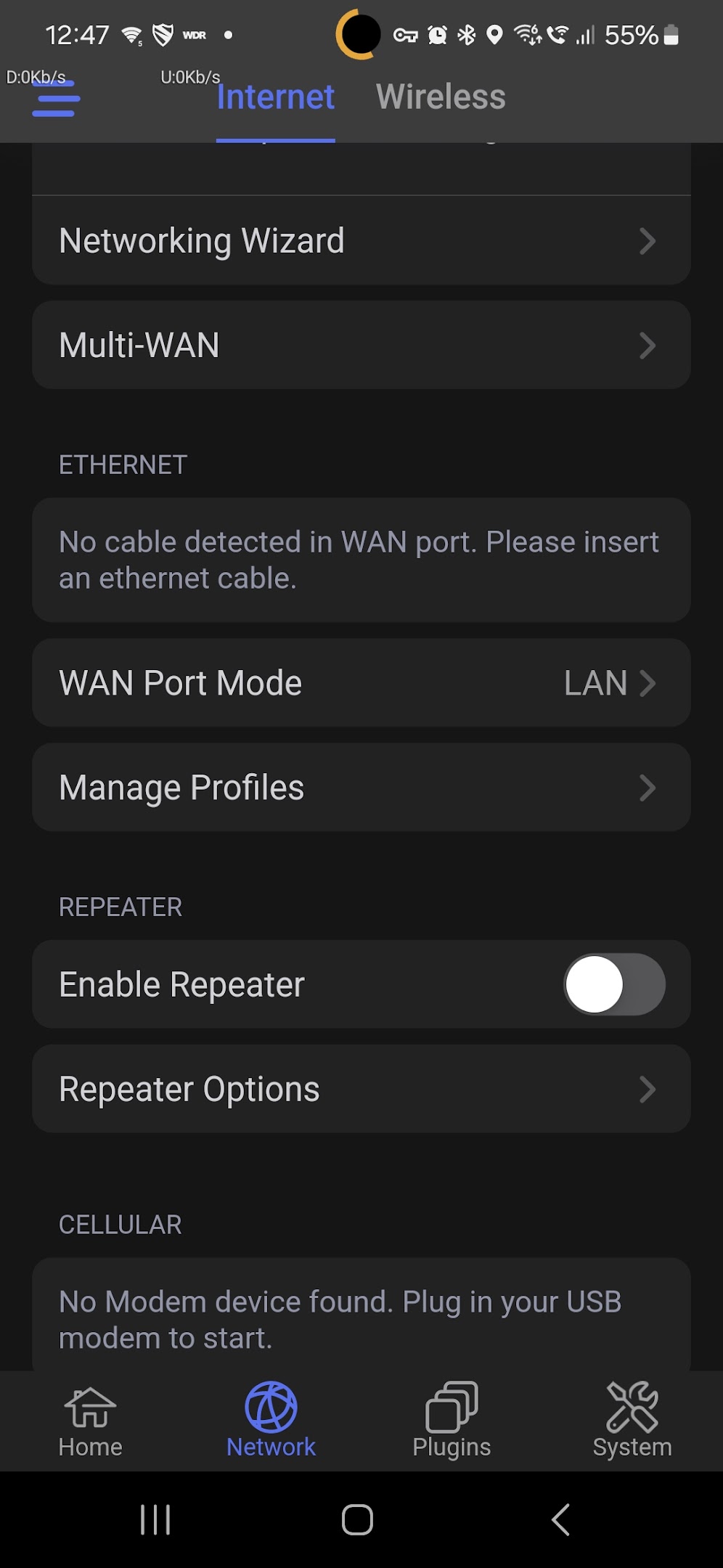

I just checked in the android app and it shows the same problem:
