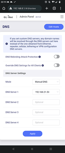

I just need to know where I enter the Ip of DNS on GL router, because inthe custom section, it forces me to choose a provider from the list, which does not make sense .
At my AXT 1800, I can set in ‘Menu - Network - DNS’ in the second Section ‘Manual DNS’. There I can enter any DNS.

I see. At least in Firmware 4.1.0 I get the list, but just start to write in the text box …
