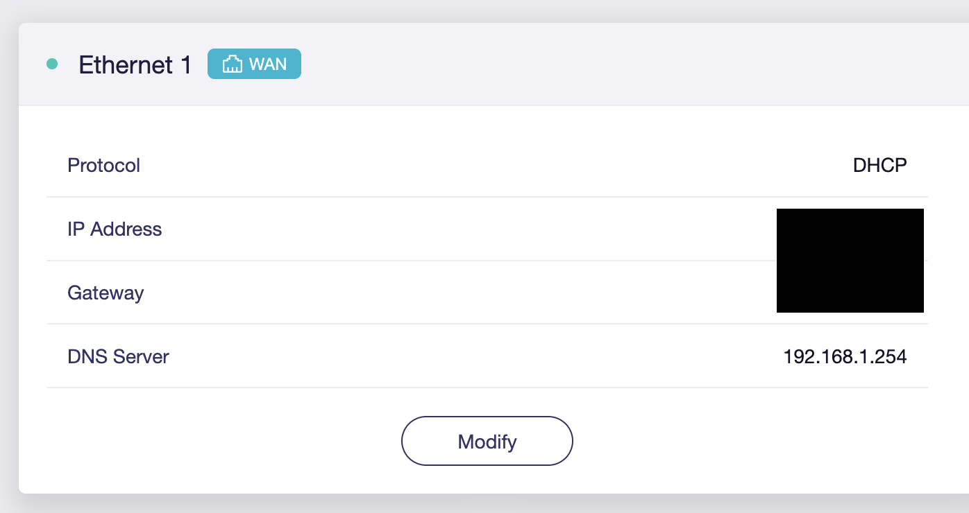

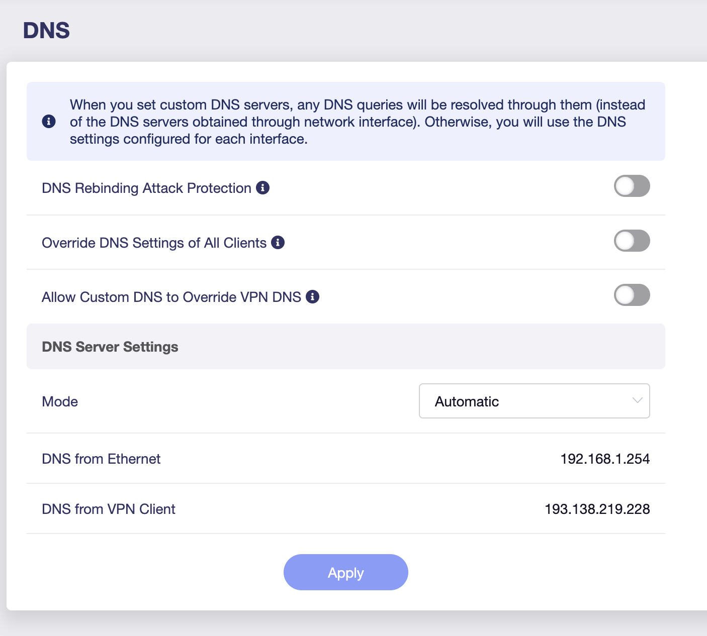

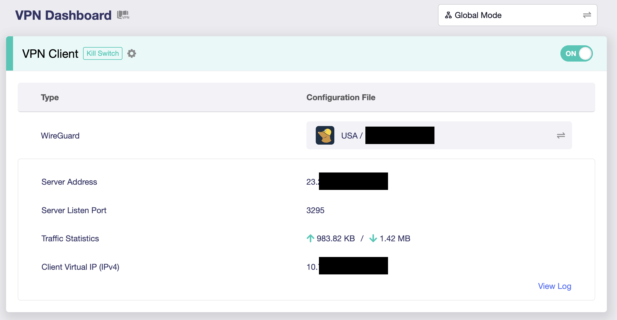

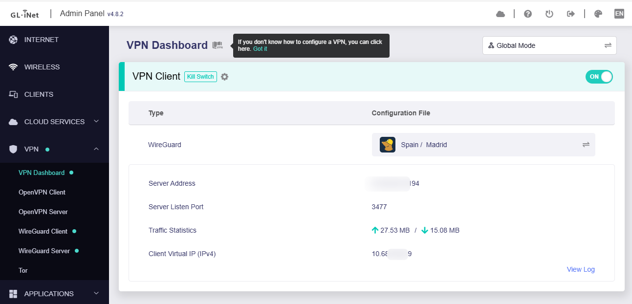

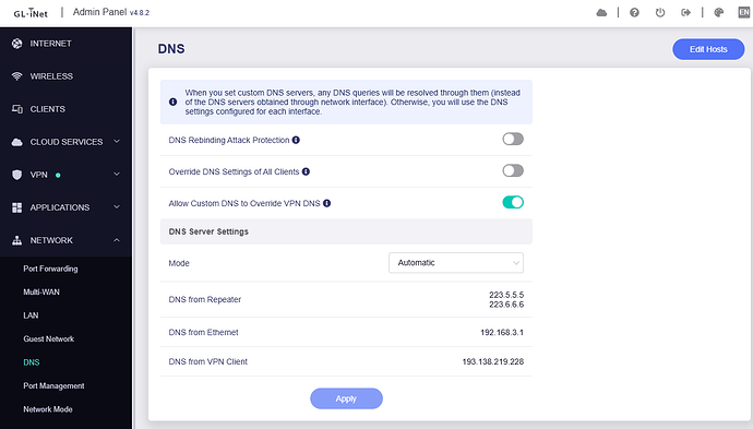

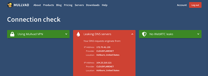

I have a GL.iNet GL-MT6000 (Flint 2) router running v4.8.2. I have ATT fiber, which requires me to use their modem/router. I have set up their router in IP passthrough mode and have my Flint connected behind it getting WAN using DHCP. I’ve set up the Mullvad client and the VPN connection seems to work fine except that it is leaking DNS requests. I believe that ATT hijacks DNS requests to use their preferred DNS servers, but if the VPN client is active, everything should be piped through the VPN tunnel regardless. Please let me know what could be going wrong. Thanks!
Photos

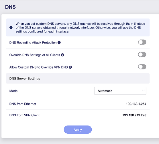

  1. Does your test client pc system or browser enable encrypted DNS?
    Change to another client to test again, like phone/pad/, etc.
  2. Is the ADG enabled on the router?
If the DNS is UDP 53 request, it will be redirected by Mullvad server (without leaking).
Just find where is enabled encrypted DNS.
If the location of DNS server is the same as the location of VPN server/node you choose, there is actually no DNS leak, you can test it more through dnstestleak.com, ipleak.net.

I tried with different browsers and on my phone and it still shows that DNS requests are leaking.
I have tried different sites and they all show servers that are not the expected Mullvad servers.
