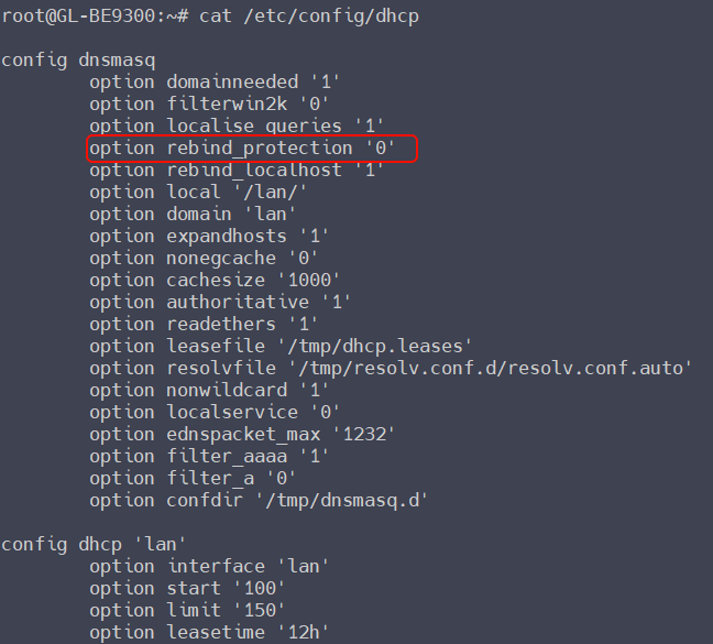

It seems odd — I'd like to check the configuration: cat /etc/config/dhcp
The option rebind_protection '0' entry under config dnsmasq corresponds to the "DNS Rebinding Attack Protection" disabled of GL GUI.
Please try to SSH to the router, and using uci to configure this option, to check whether the GUI updates accordingly (1 is enable, 0 is disable):
uci set dhcp.@dnsmasq[0].rebind_protection='1'
uci commit dhcp
uci set dhcp.@dnsmasq[0].rebind_protection='0'
uci commit dhcp

PROBLEM SOLVED!
Here‘s what I‘ve done:
  • Execture uci set dhcp.@dnsmasq[0].rebind_protection='1' in the shell
  • Gave me an error pointing at line 77, so I looked at line 77 in the /etc/config/dhcp file
  • At line 77 there was written the following: address=/domain.tld/internal_ip
  • With this I wanted to redirect all queries going to domain.tld to a tunnel ip, so that these queries dont go out to the internet
  • I deleted this line in the dhcp config file and executed following command: uci commit dhcp && /etc/init.d/dnsmasq restart
  • Then the DNS rebinding attack protection was disabled in the GUI
  • After restarting the Wireguard tunnel everything worked as expected (ping and traceroute and DNS working as expected)

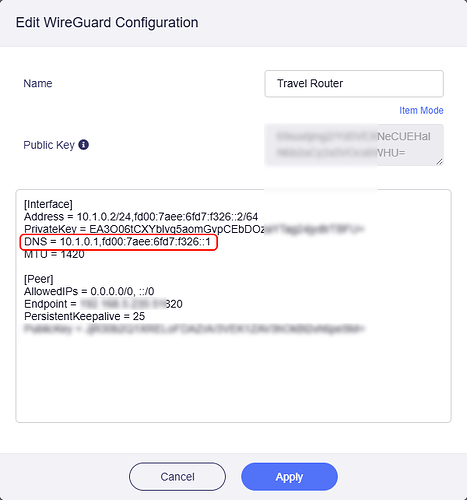

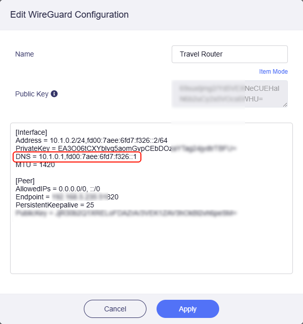

  1. Ensure the DNS in your VPN profile points to the VPN server's tunnel IP, for example:
  2. Override DNS Settings of All Clients, recommended to enable. Leave other settings default, and DNS mode is auto.
All DNS requests of this router (VPN client) will be through this VPN tunnel to the VPN server, where they will be handled by VPN server.
