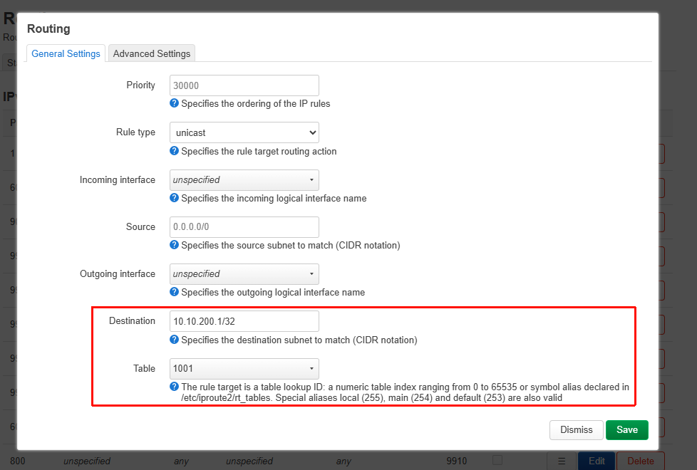

In ATX1800 v4.8.2, when the VPN is in policy mode, only the domains included in the policy are resolved via the VPN DNS.
All other DNS traffic is routed out through the WAN by default—even if the DNS requests originate from LAN devices and their target DNS server is included in the VPN policy.
We plan to improve this behavior in future versions. Specifically, if a DNS query originates from a LAN device and its destination DNS server is included in the VPN policy, it will be routed through the VPN tunnel.

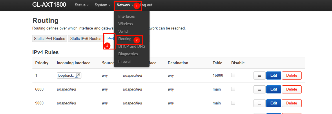

For the current version, you can add a rule under Luci → Network → Routing → IPv4 Rules to force all traffic destined for the VPN DNS server to go through the VPN.
