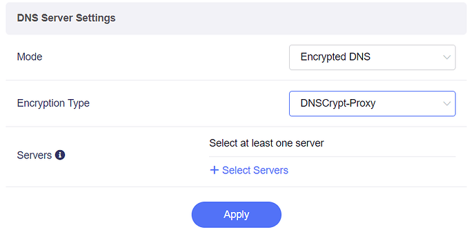

Why do you want to start via shell?
You can use the UI to use dnscrypt directly.

It seems turning AdGaurd on makes DnsCrypt-Proxy inactive! I can see the above setting only when I deactivate Adguard. Why?! I wanted to use the dnscrypt-proxy server in AdGuard Upstream DNS servers list.
Also, setting the dnscrypt-proxy config through the UI is not sufficient for me. I want to used relays to anonymize my DNS queries. I was able to do that by adding these lines to the config:

Here:

I know about that setting option but for me that's not the point of using dnscrypt-proxy. As I said earlier, I want to use the "relays" options to anonymize my DNS traffic. If I only wanted to encrypt my DNS traffic, I could also use DoH or DoT. Technically, it should be possible to use dnscrypt-proxy alongside adguard.
Anyway, I disabled adguard and started dnscrypt-proxy with the parameters I wanted. I use the blocked-names.txt file to block ads with dnscrypt-proxy.
