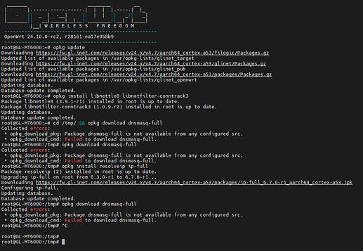

I installed v4.7.0-op24 firmware based on OpenWrt 24.10.0-rc2 on GL.iNet GL-MT6000 Flint 2.
Wanted to install dnsmasq-full but got the following:
/tmp# opkg download dnsmasq-full
Collected errors:
 * opkg_download_pkg: Package dnsmasq-full is not available from any configured src.
 * opkg_download_cmd: Failed to download dnsmasq-full.

Did you execute opkg update before? This is necessary to find the packages.
Thanks for reply. Yes, I did.
Today I solved this issue installing dnsmasq-full in LuCI. I didn't even have to remove dnsmasq first and it didn't throw any error.
