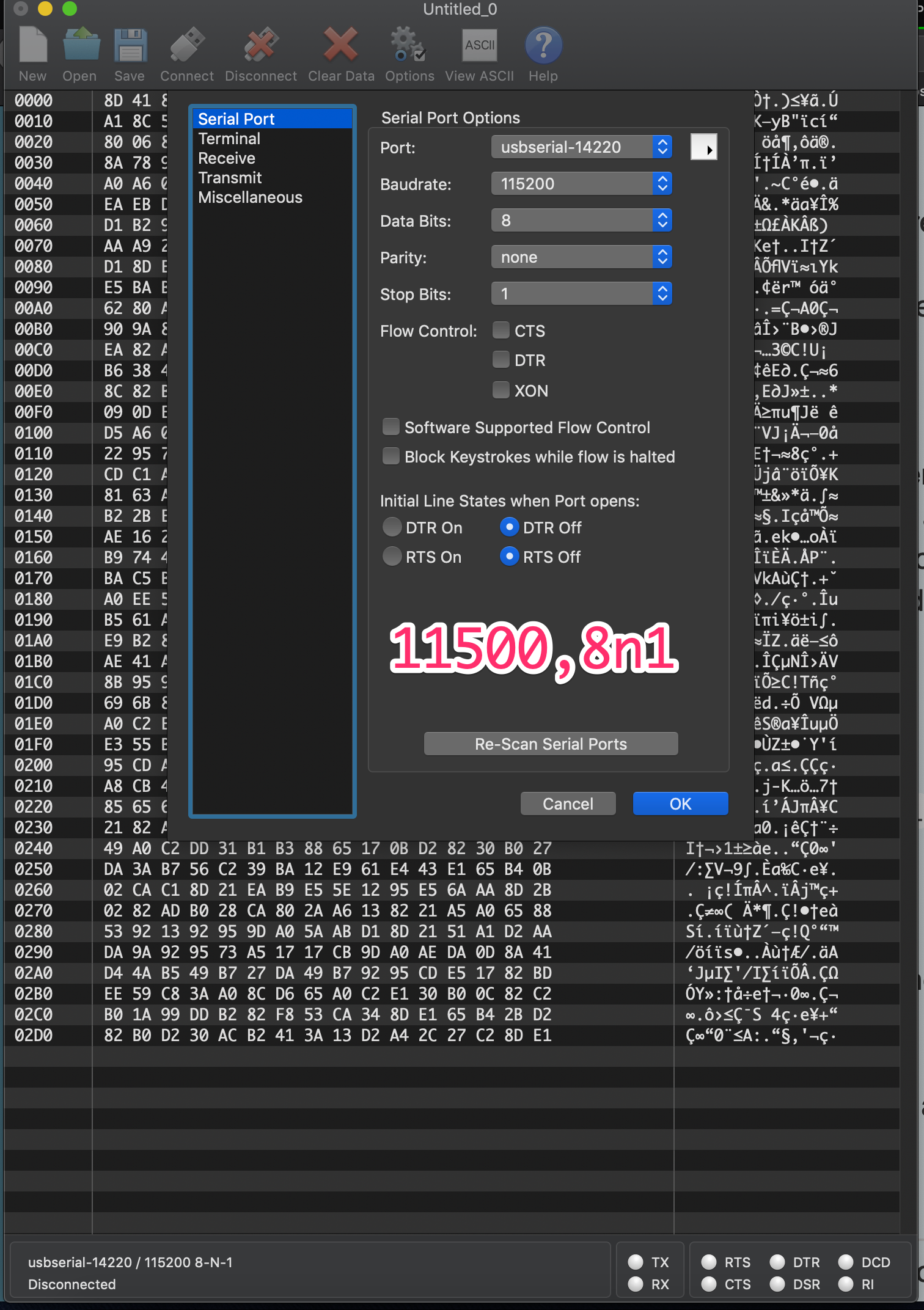

I am attempting to get a working UART on my GL-X750C4 and am having some trouble.
Attached is a screenshot of my terminal program and the settings i’ve applied to the serial port dongle. It does appear that i have the baud rate and parity / flow control settings correct (they do match the settings here: UART Serial - GL.iNet Docs)
but despite those settings, here’s what i get out on the UART:
çAàU≠»ÎÒ†.)≤¥ã.Ú°åV™›-.K—yB"ïcí“Ä.ä¬Ä.Ç öå¶‚ôä®

(coolterm won’t let me copy the HEX encoded data, so please see the attached screenshot for that)
( i will post more pictures in more posts… the forums are limiting me to 1 img per post… grrr

because i’m limited to just one pic per post, here’s the picture showing the data that i get on the UART on device boot
