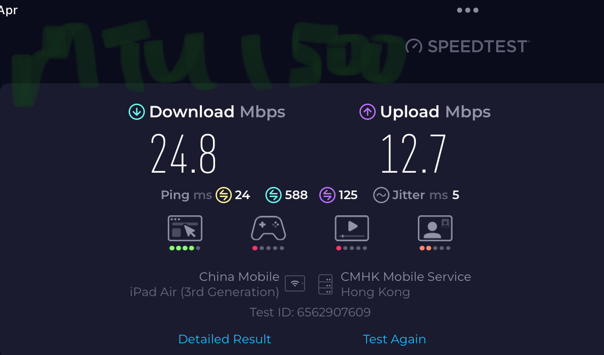

Thank you for trying Cathy, much appreciated but unfortunately I wouldn’t call it a success.
When it connected, which was maybe 1 per 4 attempts, it was quite flaky, dropping connection, strange speeds.
Back to stock MTU (1500) it connects again, more stable. See logs.
