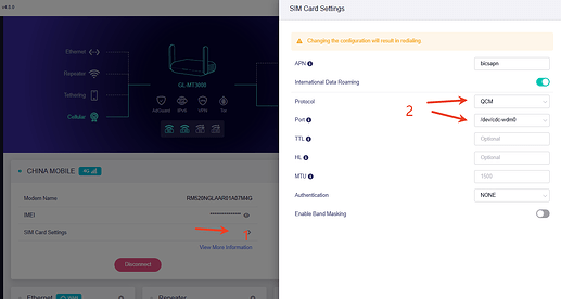

You can select the cellular protocol and port in FW v4.8, as shown below, and then see if it works

Hi Cathy,
Unfortunately that interface does not show up on my unit, on the GLiNET GUI; despite (see attachments), /dev/cdc-wdm0 showing up in both sms-tools and on the CLI when I issue these commands:

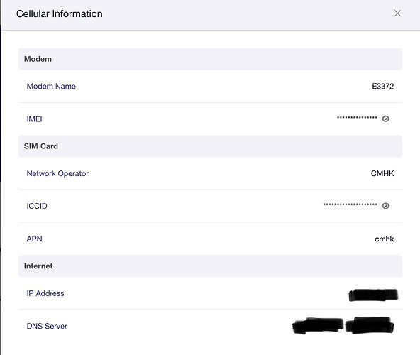

Hello, just want to confirm, can your device work properly without using /dev/cdc-wdm0?
Could the cellular information (including the name of the operator, IP address, etc.) displayed on the GL.iNet Web GUI be shown correctly and accurately?
Yes. But the speed is not so great. I’m not sure how much is provider and how much not being in modem only mode (if that is the case).
You can modify the MTU value and set it to 1428 to see if you can get a better speed.
Ok I will try that. But no update on this interface
/dev/cdc-wdm0
not showing up in the main GUI?
