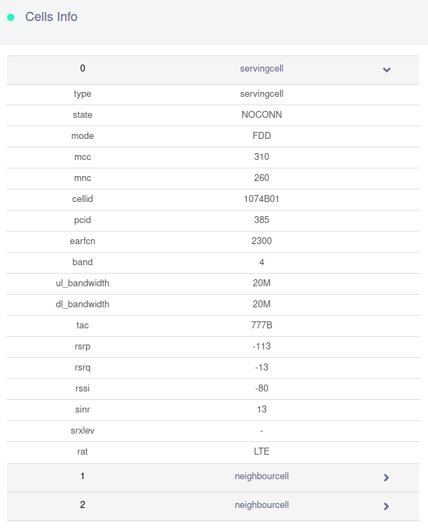

Attached: modem setting / cells info
Please note that the signal is not good. So it may be due to weak signal.
  • Total of about 5-6 disconnects
  • Tethering (easytether) works without disconnects - can rule out the signal possibility, I think
