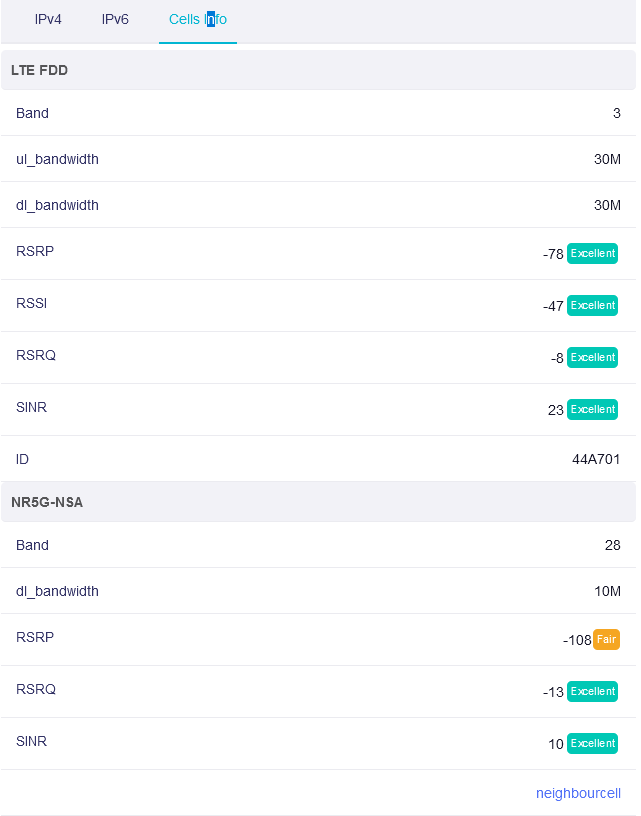

Going from my 5GEE router to the Spitz however, ive gone from ~150mb/s down to 15mb/s
I noticed in the band info the ul/dl bandwidth is set to 30M, not sure how to correct this?

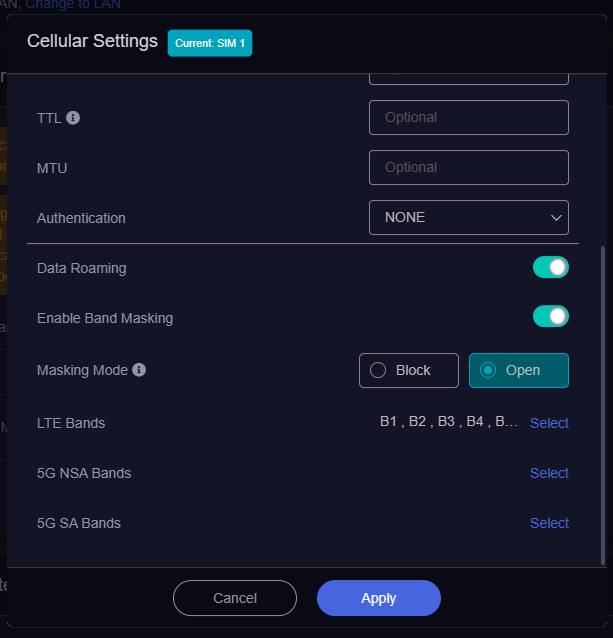

I also cannot figure out how to edit the APN to disable ipv4 and run ipv6. EE is ipv6 only on the FWA connections, so the spitz appears to be having a hissy fit with the ipv4 connectivity over the APN.
Finally, my local mast is 4G only, there is a 5G mast 5/6 miles away but the signal is poor. The device appears to be trying to use the very poor 5g signal over the excellent 4g signal (the 4g mast is within 200m of me, direct line of sight, no obstructions)
